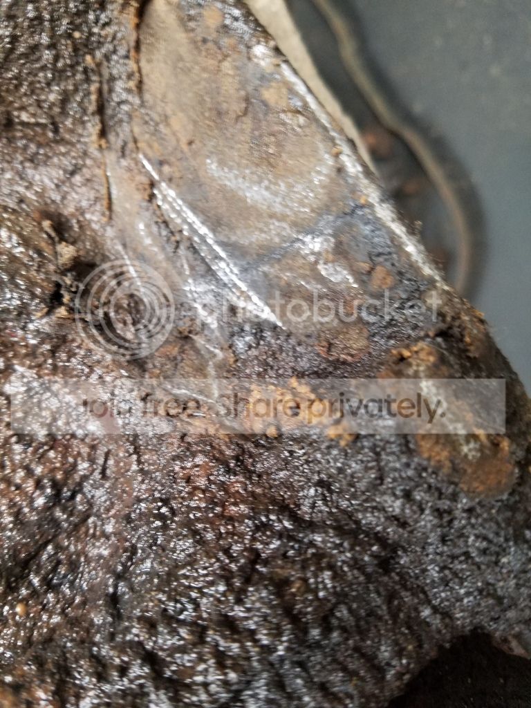

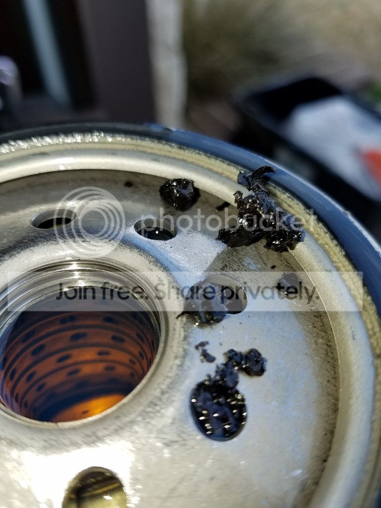

I currently have the setup waiting to go in but I had low fuel pressure in the 6.2l so I had already pulled the engine in my head. Just needed a fuel filter. But it got me thinking of when it shits the bed. I am now forced to do the trans swap because i have somehow cracked the th400 case with my mall crawling.

Heres the crap that showed itself when I pulled the filter. Time for some fuel lines I guess.
cracked case.
