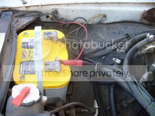

I've got one D31A, I fabbed a custom battery tray.
Good battery. But big and heavy.
I bought the Blue torch fabs battery tray specifically made for optimas:D BTW, I have had both optimas....red and yellow. Never had a winch with the red, but haven't noticed a difference.
