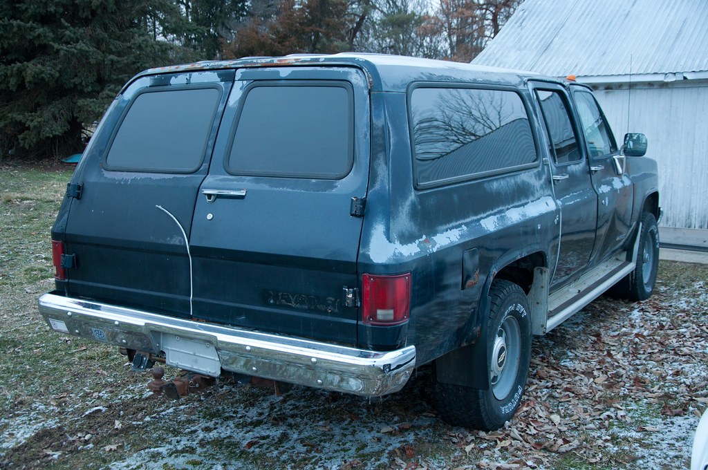

But there were no wide 16's, correct? The wider 16.5's on my new Suburban are the first factory (but not factory on this truck) wide wheels I've seen in person.

Wheels on your Sub look cool. Pretty rare if they are GM.
