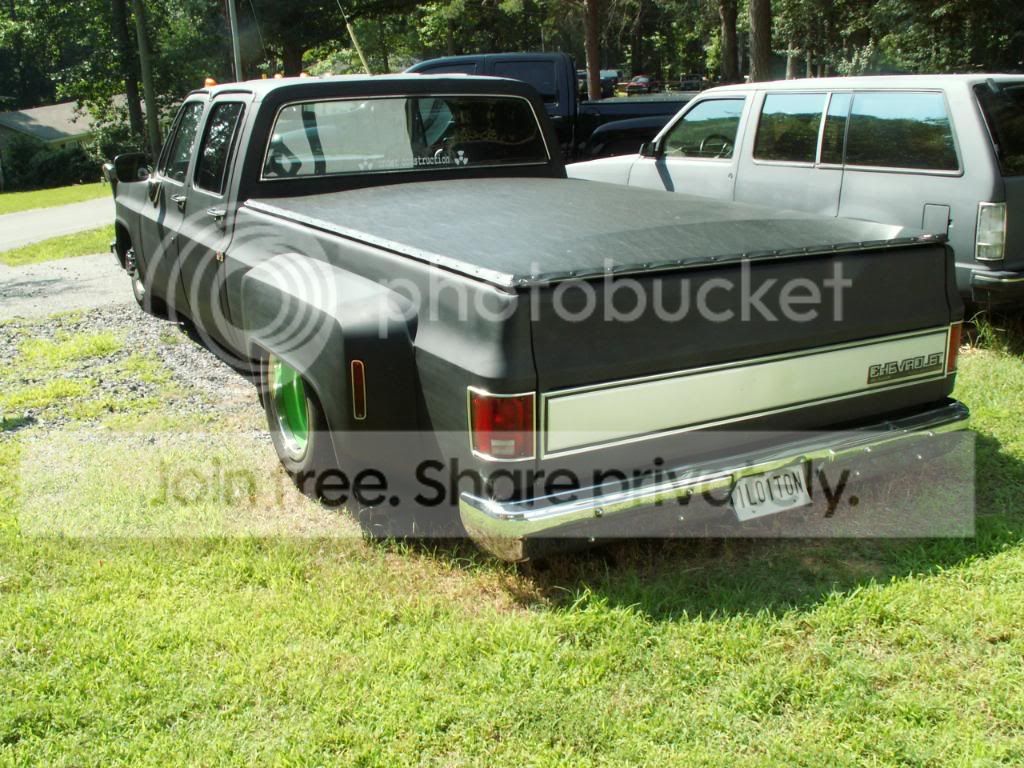

I don't know about your hitch question, but as for the bumpers, I have seen blazer/suburban rear bumpers mounted on to pickups several times. I don't know what mods (if any) are required. I am thinking of doing the same to my 88 R30
I've seen the reverse where a guy put the step bumper on his Blazer. Involved a bit of cutting and welding...I believe he joined the bumper brackets after cutting them in half and using the Blazer "frame" end with the pickup "bumper" end. I think. It's been a while.
This truck is for sale in the classifieds. Might want to pm him and ask how he mounted the rear blazer bumper
Don't need to ask that guy. Those bumpers came on the regular trucks, too. Just two out of the four brackets are different than Blazers and Subs.
My '85 K30 has that same bumper in the pic. I'm wanting to put the same thing on my '87 V30. I like these better than step bumpers.
They do!?! Well you learn something new everyday. Every 73-87 pickup my family has owned all had step bumpers.
