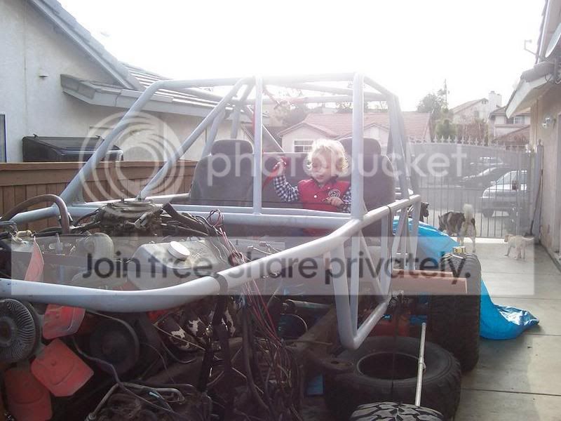

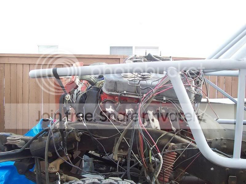

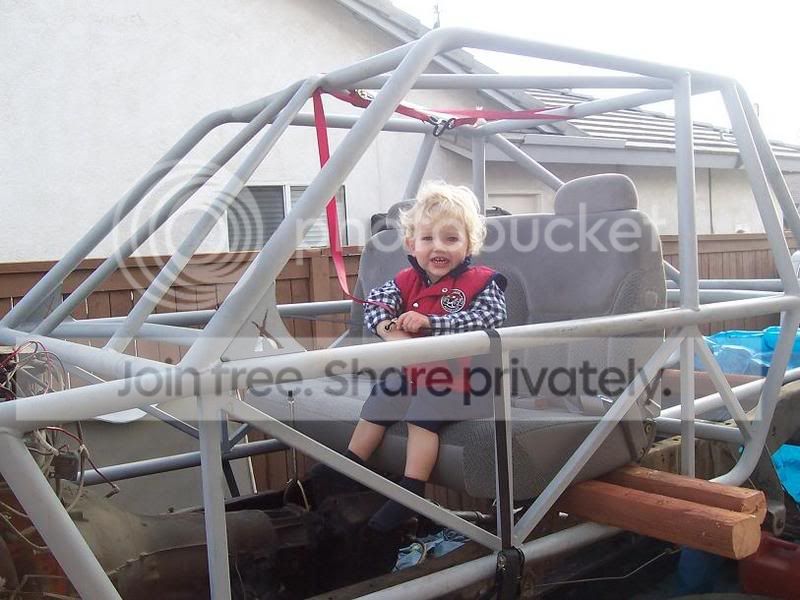

Thanks guys, Im ditching the core support, reusing the front tube grill, I'll figure out a way to mount it. I'll probably buy a shorter aluminum radiator and lean it a little. Here are some pics of it in its place itys going to sit. It is a truck frame rear tank is a burb 40 gallon tank that Im not going to reuse I'll be using a 20 gallon aluminum tank, thats about the biggest you can fit inside of the dimension restricted area. I will also ditch the fan.
