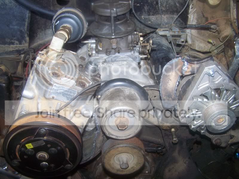

York w/serpentine belt
Not sure what the application is but i've got one on my York. I bought it from www.KilbyEnterprises.com before they jacked their prices way up.

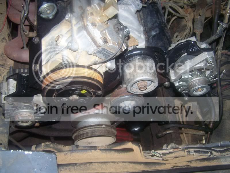

anyone know were to get the yorl to gm small block chevy serp belt mount were the a/c comp would be?
i do not want to give killby that kind of money he is asking.

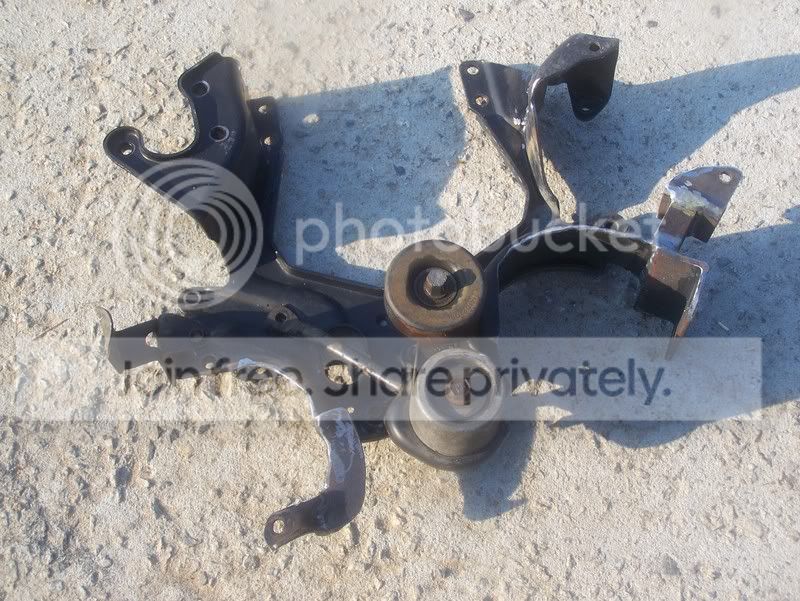

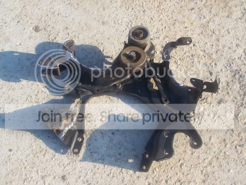

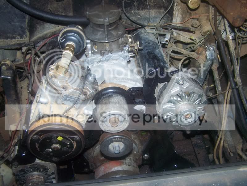

I did this. The serp pulley can be found on Semi's.
Removed and cleaned up.

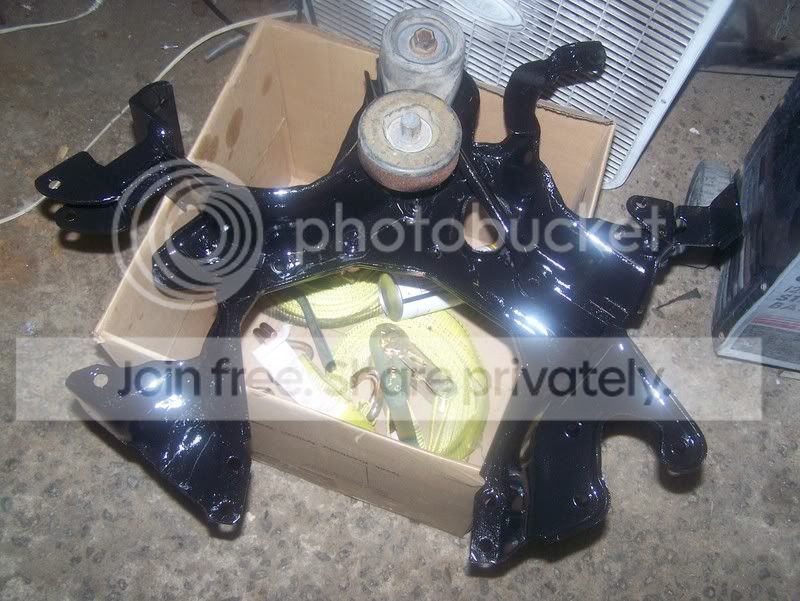

Painted.

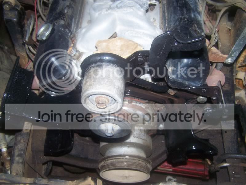

Bolted to the block.

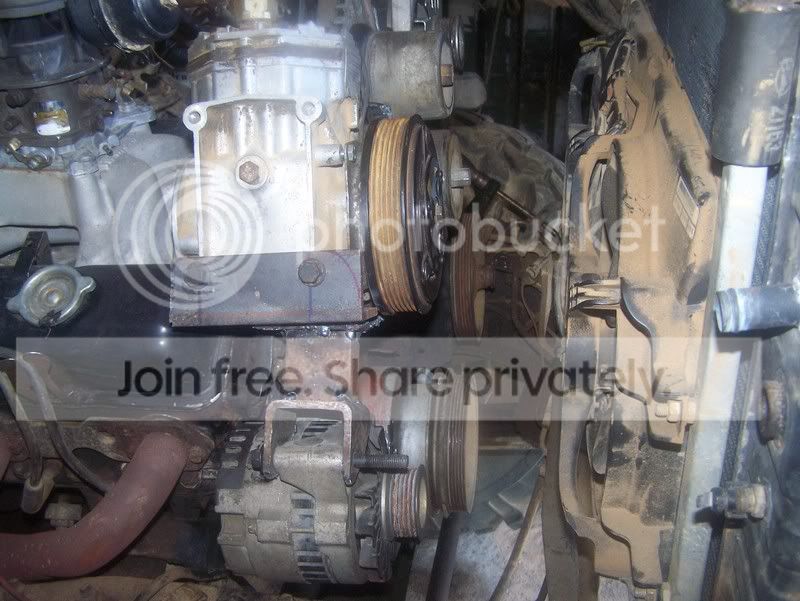

A few accessories.
I may machine the one I have if shipping turns to be way expensive.
$126 shipped to overseas, not bad :D $81.04 for clutch, $45 to shipping.
I stopped by on our tool dealer, they have all sorts of tools and parts, and pulleys. They even could supply one with right grooves and od, only the center would have to be machined off. Not too much work on that option, and pulley wasn't too expensive, but little bit more money and I get all new pulley AND clutch, so why bother.
All Yorks I've seen have two groove pulleys, but mine has one with some kind of flywheel. Is that some special model or what?
