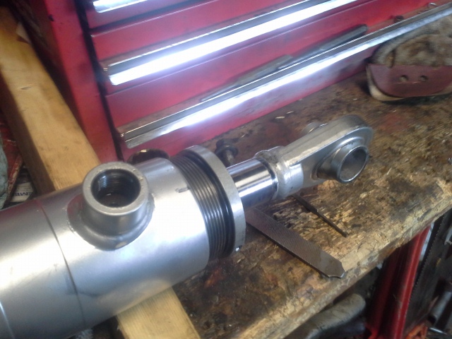

85GMCJD Spun the ram back together and re installed
MorganBrady
I measured total stroke bumpstop to bumpstop on the steering with unlimited ram installed first so I could make the limiting sleave exactly right....Then when I reinstalled the ram, I also removed the factory bumpstops from the steering knuckles so there was no chance of a binding situation.
