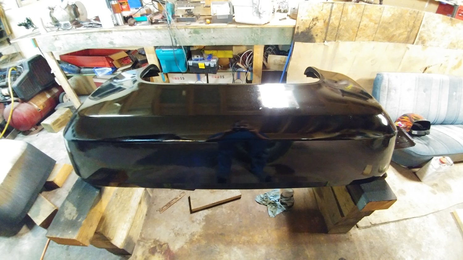

1980 stepside Diamond plate steel floor build
before the exoxy we chemical treated the minor surface pitting to get it clean...it will all get filled later with poly spray filler and block sanded
