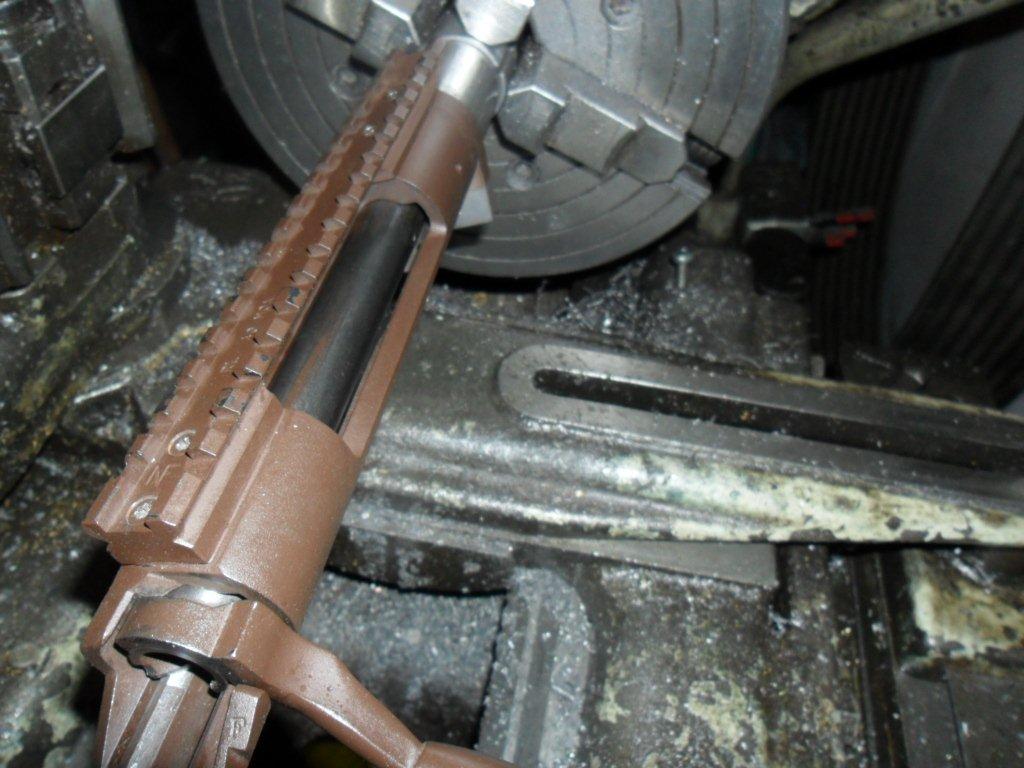

Bolt just closes with .001" clearance, a .002" shim on the guage and it wont close. Just right.
