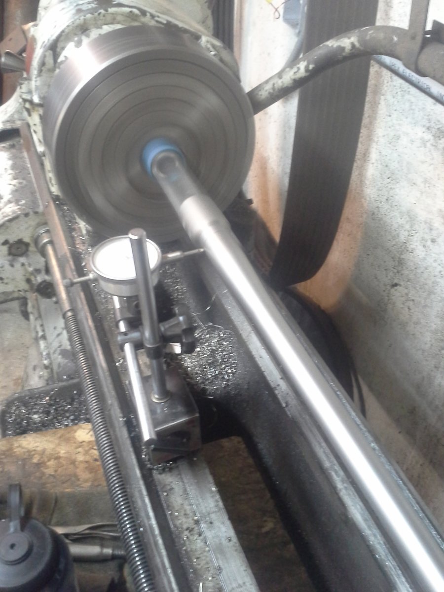

for barrels too short for my head-stock on my lathe I cut the threads while on a brass live center. Old lathe but reconditioned well
