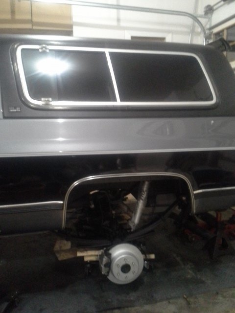

bds suspension upgrade and Diffs upgrades my brothers 89 Jimmy
The late model rear diff works good for an easy disc brake upgrade, 30 spline axles (early 10 bolts 28), wider track width if sticking with 1/2 ton
