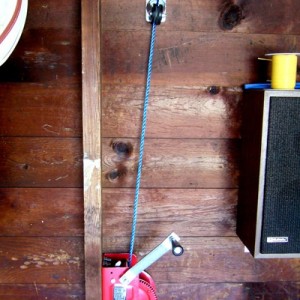

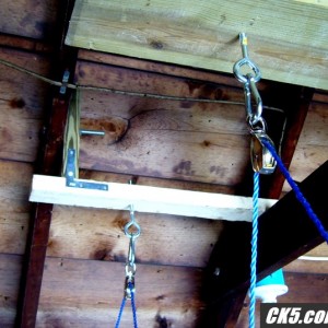

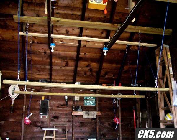

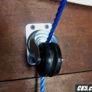

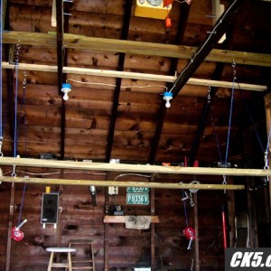

Pulley system set up in garage to lift my fiberglass full top off of my '73 Chevy Blazer.
