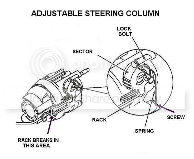

So I got the old ignition out, and swapped the new one in, but when I turn the key there is no resistance as if something is broken. I removed the cylinder again and it appears the rack is broken inside the column.
Does anyone have a part number for it? And how do I change them out?
Could be the rod that leads from the rack. I broke one on my '75. They are different between the tilt and non-tilt version.
Just thinking about it, drop the column at the mount and lower it down. That will give you access to the switch. It should have a couple 1/4" screws holding the switch on the lower end of the column. Pull it off and you should expose the rod. Pull down on it and see if it moves or not. It shouldn't move.
Here's a view of a tilt column assembly.
Did you get the rod out of position? Did you have to punch a hole in the column, or had someone already removed the ignition cylinder before you?
