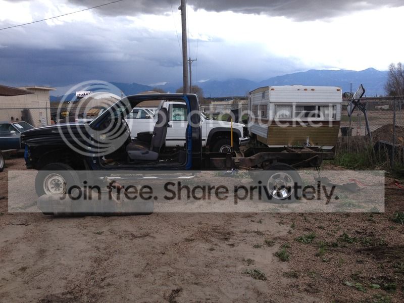

How it looked when we got it.

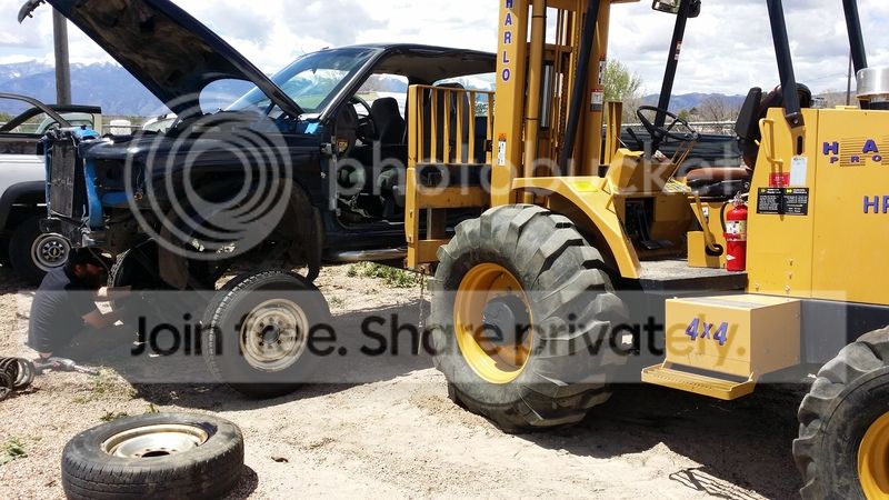

With the long weekend here, Me and the lady decided to start bolting some stuff together.
hanging the front axle;
rear axle in and on all four wheels!

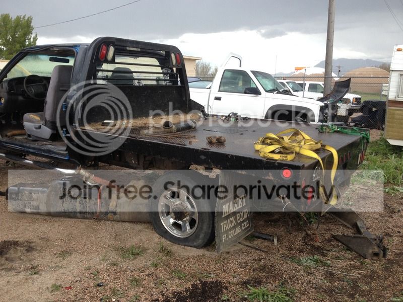

old bed removed (inside was beat to hell) for CM flatbed replacement. And
fuel tank removed for Diesel sending unit install.
CM flat bed on frame. And that is how it sits as of this afternoon.
Not sure if the flatbed will stay or not. Kind of diggin the factory sport look in this color with an original dually bed.

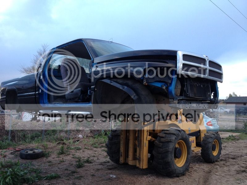

Next is to pull the cab and front clip for complete powertrain install. Waiting on input shaft and clutch for the NV4500.
