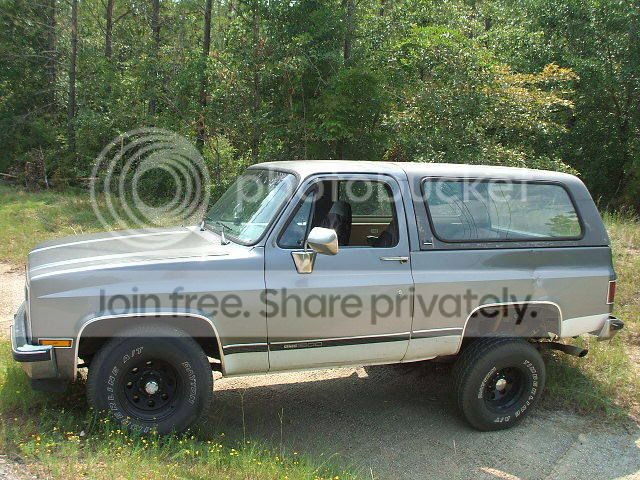

I got these seats for $75(both) at the local junkyard. I would have gotten the fold down center console that goes with it but it was going to cost $200 extra. Right now I only have one bolt in each seat(super tight). In both seats, I used the front inside factory bolt hole(nearest the tranny hump). I'm going to drill the holes to mount the seats this afternoon or tomorrow. Taking the flat bar, drilling holes in it where the seat bolts can go through the flat bar, placing them on the under side of the truck as extra bracing. I'll take pics of that part when I get it done.
The Truck and this is the furtherest offroad its been so far:haha:
