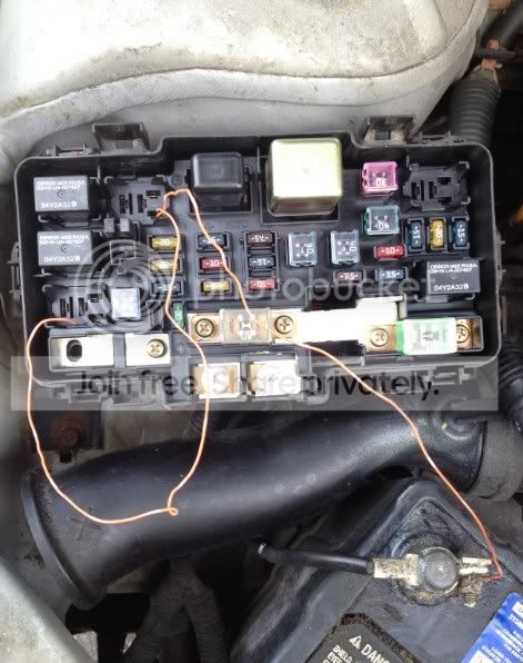

So, weird thing. I jumped the condenser fan and compressor as such:
The top plug being the compressor, bottom left being the fan.. and when I connected it to the terminal, the radiator fan kicked on, but NOT the condenser fan or compressor.
Yet, with the relays in like normal, the condenser fan runs (the compressor still doesnt)
Am I missing something? Or did I not jump it right? Should I try tomorrow with just running a wire from the battery just to the compressor relay and leaving the condenser fan relay in?
Really confused.
You know everything else works. unplug the plug at the compressor, stick a wire in the compressor side plug, start the car, stick the other end of the wire on the (+) terminal see if the clutch kicks.
Really confused.
You are trouble shooting from the middle. Follow the power.
The easy way is use a meter or light at the compressor plug or like the other guy said run a 12v hot to the comp.
you need to check for power at the compressor plug. if you have power there the compressor clutch is junk. even if you take straight power to that plug if the clutch is junk it still won't come on but you need to know if you have power going all the way down to that point.
