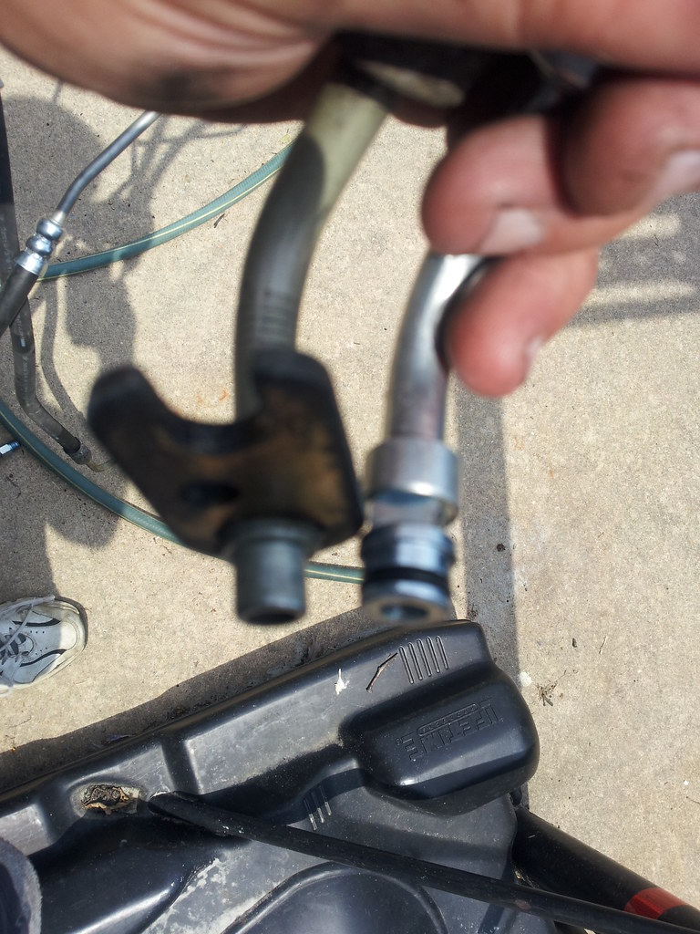

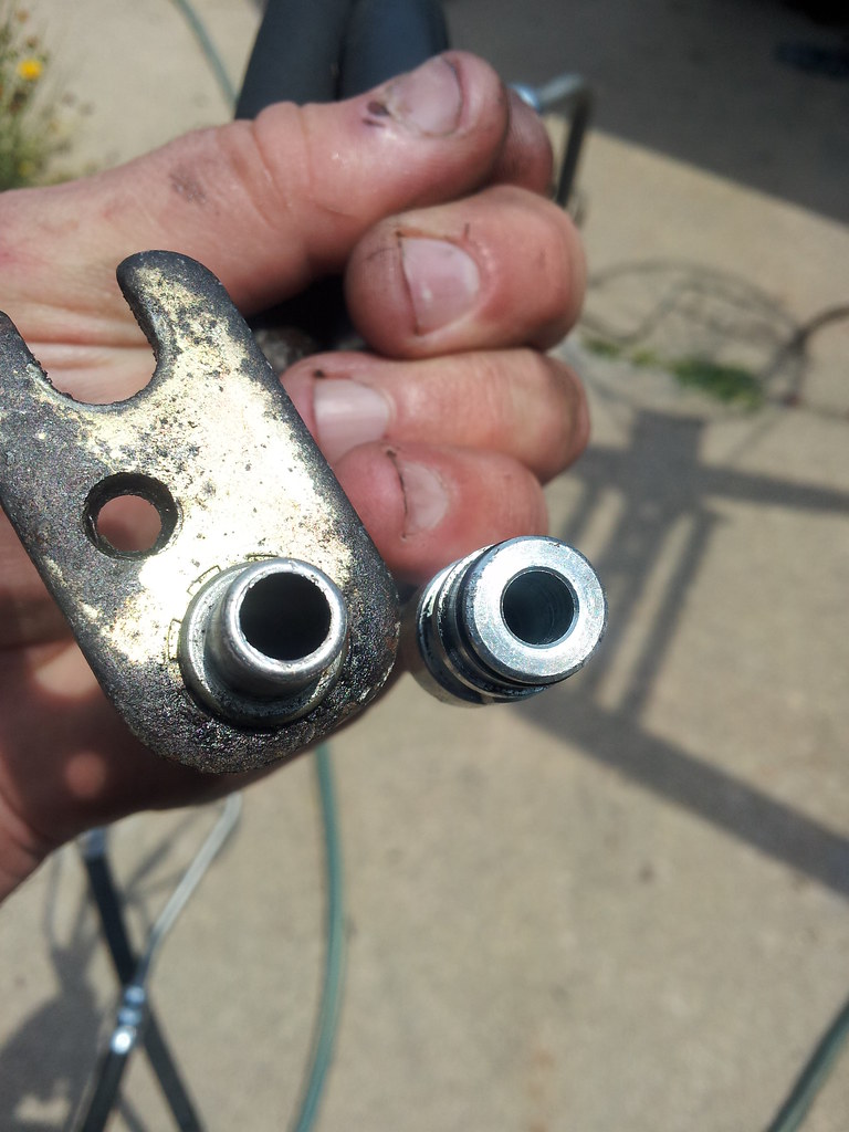

ok my wifes tb is leaking so i buy a new high pressure line.. pain to get out but got it out..... autozone had one.. go to put it in and all bends look right.... but end connector is different... and thicker... autozone guy said maybe a rubber part pulls out.. i dont know.. putting bad parts in to have a vehicle....got pics.. uploading to flicr... wasnt sure if anyone dealt with this before... autozones instructions said to remove old o ring from inside as they even show theirs is different.... in lost.....

missed focus but i got 1 more pic to upload from cell...
Untitled by TeleFragger / RootBreaker, on Flickr
well it is going to the dealer... it is worse now..

you have to remove the powersteering rack and remove the GM bushing and valve to install this hose assembly.
With the GM bushing and velve assembly removed the new hose will fit the power steering rack.
This hose is not a direct replacement and requires modification to work.
The directions should be rewritten for the correct installation of this hose, the directions would be fine with a direct replacement hose, unfortanatly this is not the case.
