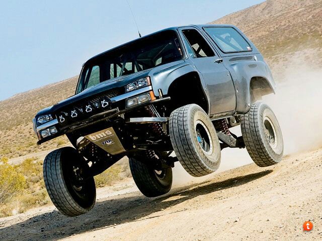

I've seen several pictures of k5's with the 07 front. Does anyone know how much is involved in a swap like that. How close are the body lines. Has anyone seen more pictures.
I know this one is way out there.
Back in 06 or so I went down to their factory in Tijuana and took a look at the first ones in person.
You will have to purchase the head lights, header panels to hold the lights and the grill. Then you will need to build a structure and tab it out to hold it all .
GM header panels are 20 bucks or so
Amazon headlights uppers and lowers are about 80.00
Grills are here and there on Craigslist for 75-150
The company has family in Mesa az and southern ca so you can save on shipping if you can get it from either place.
The fitment is ok, it's fiberglass and meant for racing but I'd give it a 6-7 out of a 10
I'll try to see if I can find the pics I took, in the pics is the under structure too.
Are they actually made specifically to fit square body's? Or is it just close enough to make work? I have a cargo trailer I might sell to finance the conversion. That would give me an easy 2 or 3 g's
It looks amazing from the right angles but the side profile looks just wrong. I'll either stay stock or get some fenders. Kinda disappointed though.
