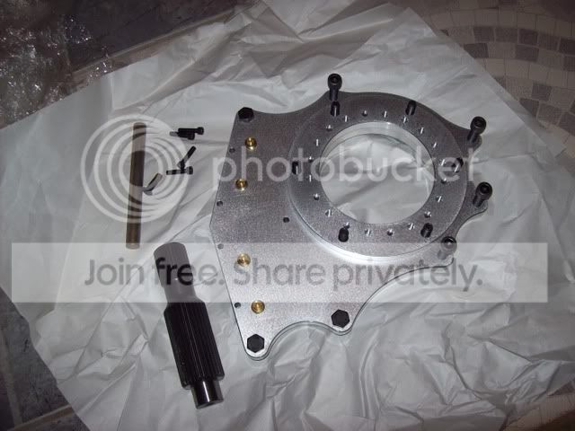

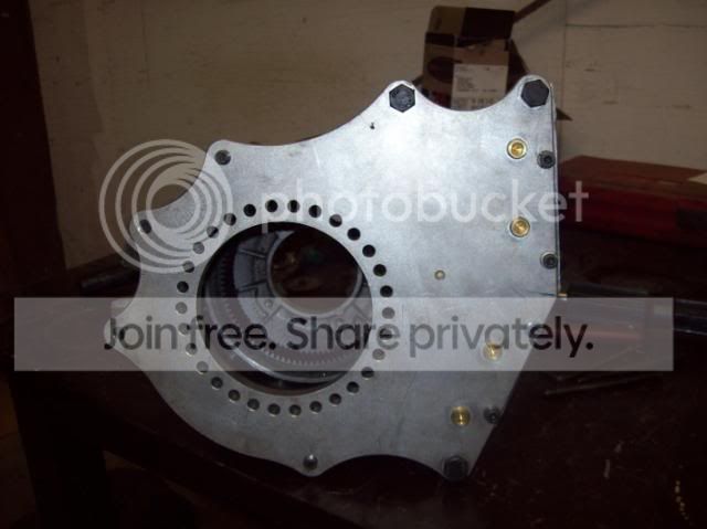

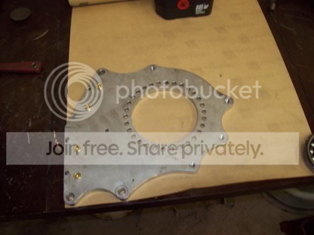

After much deliberation and study I decided to build a 241/205 doubler instead of the traditional 203/205.My main reason for doin so was more lo-range(5.33-1) and lesss money.I'm usin the 241/205 kit from D&D machine(360-779-2500).Kit includes 241 adapter plate,indexing ring,shaft,and misc hardware. $514 shipped.
This kit is built around the round pattern 205 and a DSD 241 case that can be found in the late 80's Chevy/GMC trucks that had the SM465 4speed trans or the late 80's/early 90's model trucks with the 4L80E automatic trans.My 205 case was pulled from a 89 model 3+3 with the SM 465 trans.

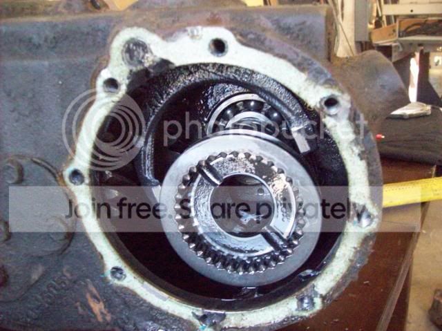

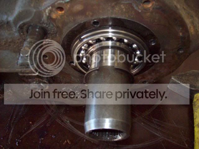

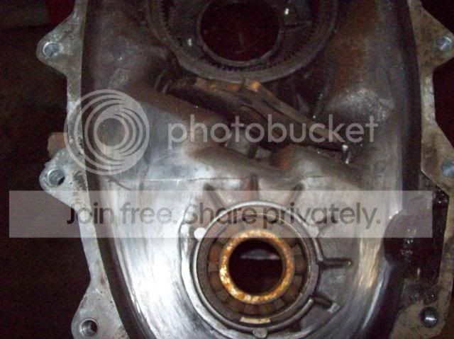

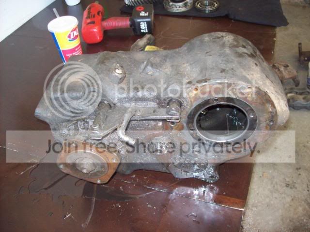

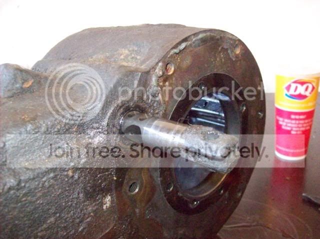

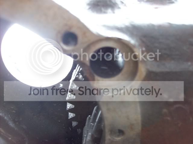

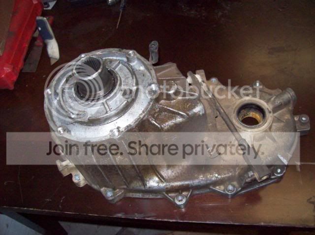

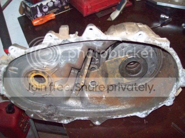

I started with a teardown and inspection of things.Case was real clean inside.

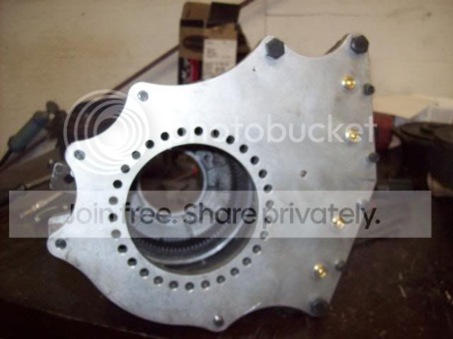

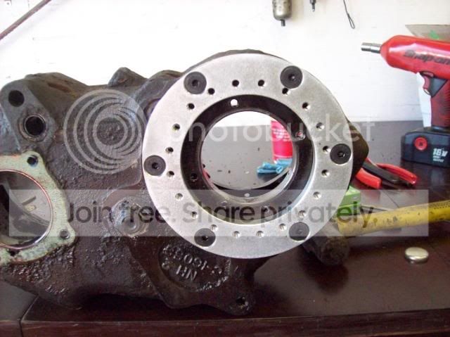

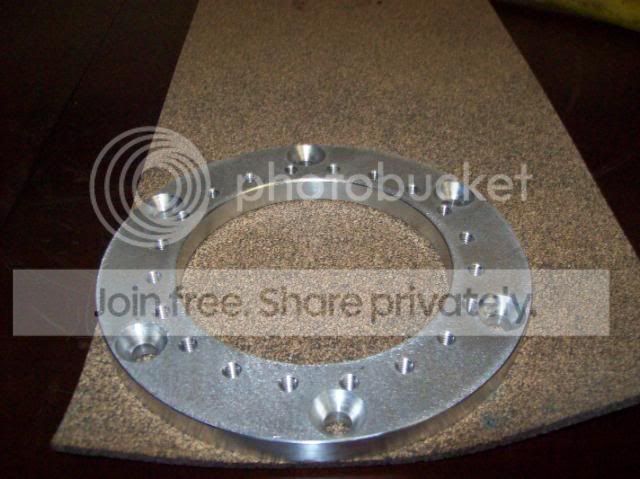

That was pretty much it for the 1st day,but I did put the indexing ring on just to get an idea of how much I can clock it and I ordered some seal's for it.

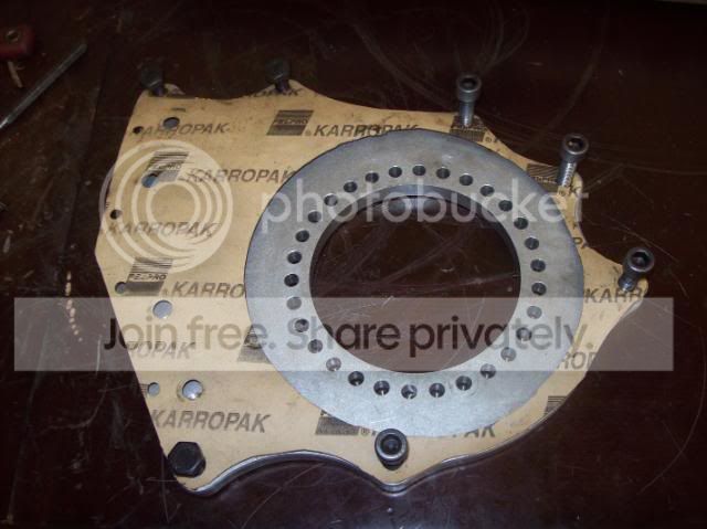

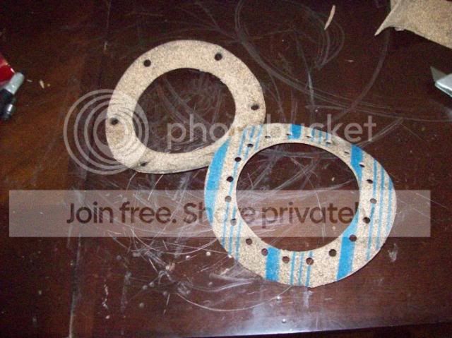

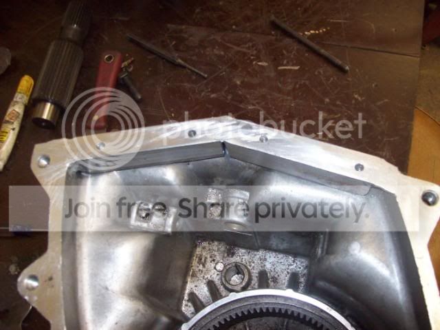

This was spread out over a 2-3 day period of working on it a little at a time.I went to Napa and got a roll of cork gasket material to make my gaskets with..

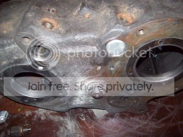

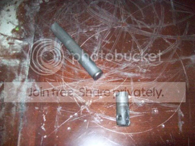

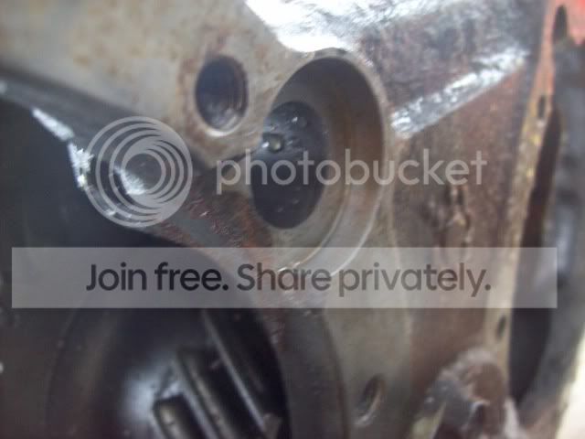

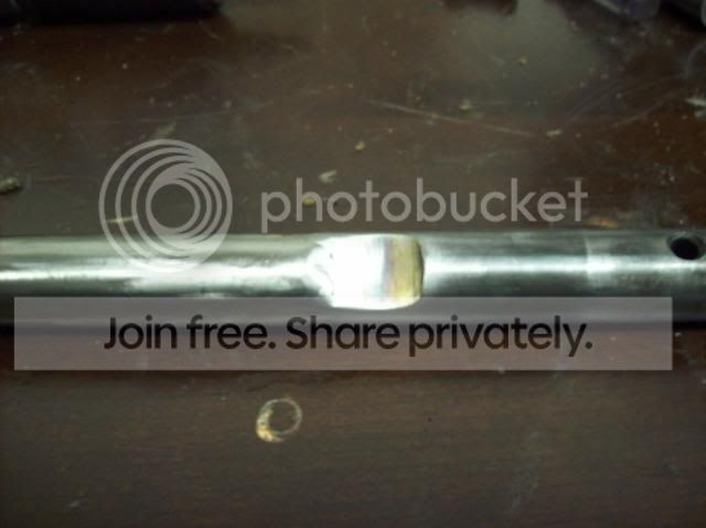

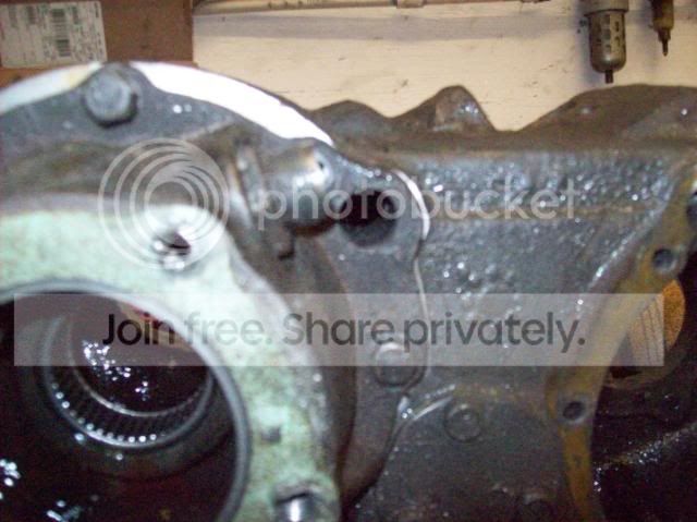

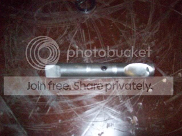

After that I put the LH shift rail back in to determine where it would need cut.I cut it two inches from the end.
Since the index ring covers the hole for the shift rail you can't use it.
So I capped it with a 1-1/4 freeze plug.

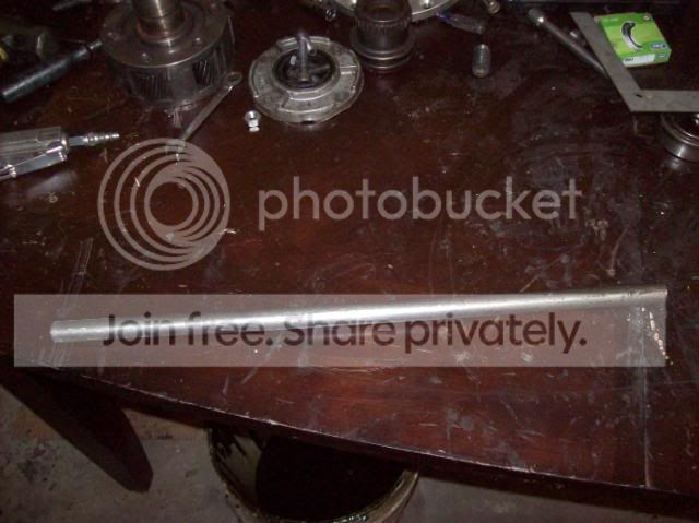

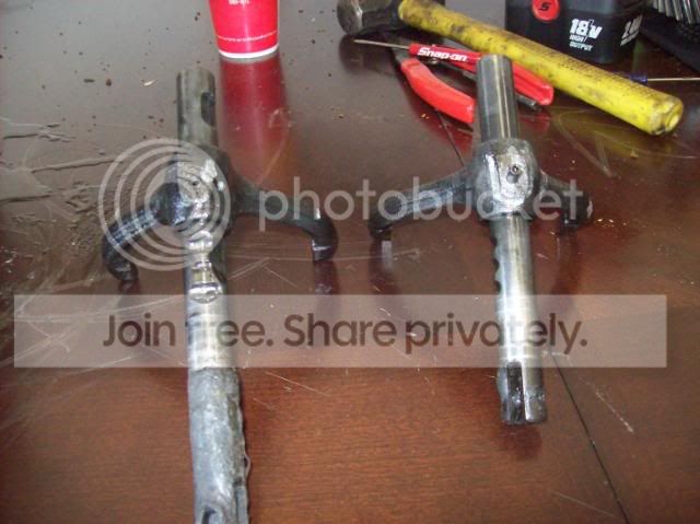

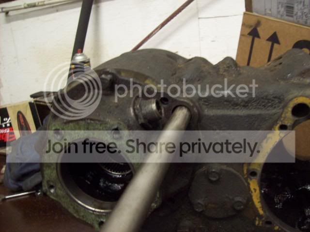

I am twin sticking the 205 while it's apart so I notched the rails too.

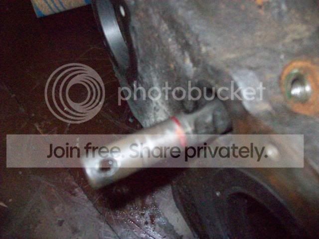

Sice I have plugged one of the shift rails I have to run the rail out the back of the case.

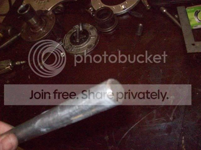

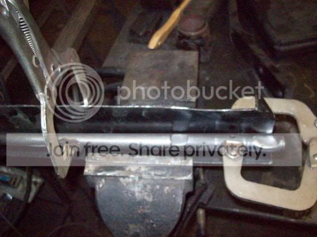

So while we were at lunch one day we stopped by one of the local machine shops and picked up a scrap piece of 3/4 cold rolled rod.

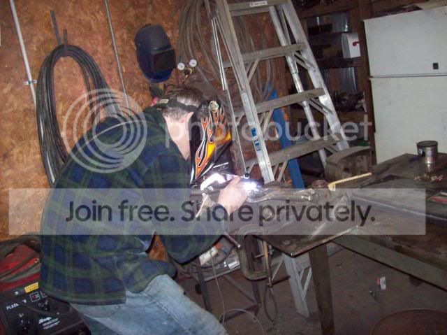

I beveled both the rod and the shift rail so the weld would penetrate good.
I couldnt find a piece of angle that I didnt have to go out in the rain and cut off so I broke a piece of 16ga to lay the rod and rail in while welding.
I had the rail/rod tigged together
I spent about an hour smoothin it out to it would'nt bind when shifted.

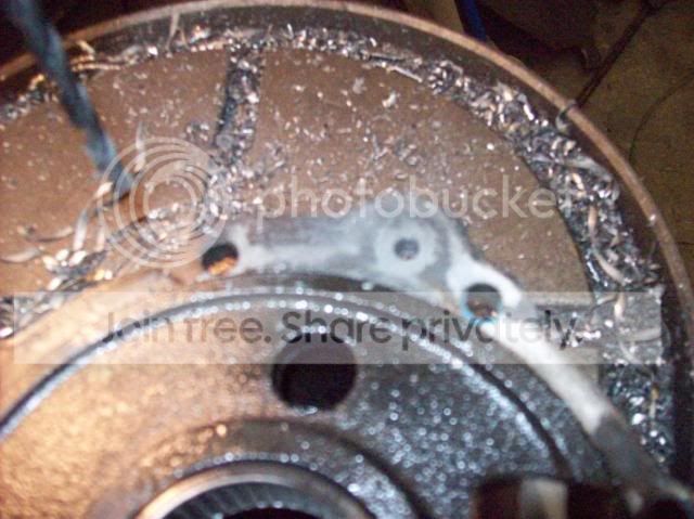

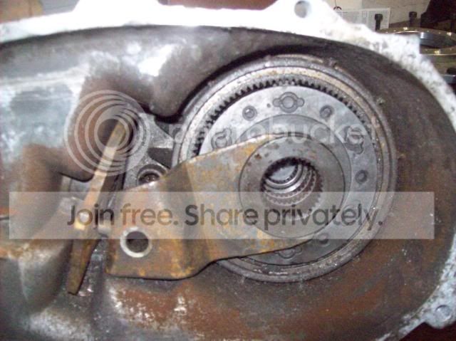

Next on the list was to drill out the tailsection so the new shiftrail could go thru it.I used the rail print on the tailsection to go by and just center punched it and drilled it.
The rod/rail is 3/4 so I drilled it 7/8 to give it plenty of room to pass thru.This will give you an ideal of what it will look like.
I'm sure somebodies noticed how close the rail is the the speedo hookup,so to remedy that Im goin to use a Dodge 205 tailsection.The Dodge is the very same it just puts the speedo on the opposite side of the case

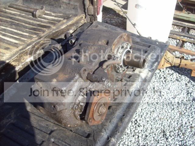

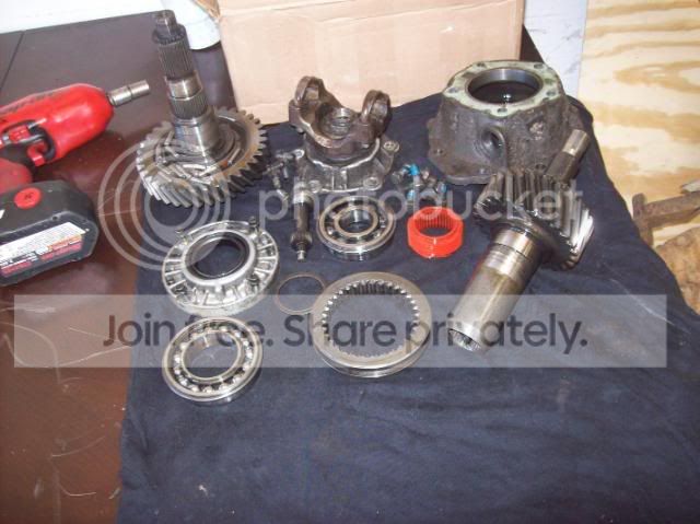

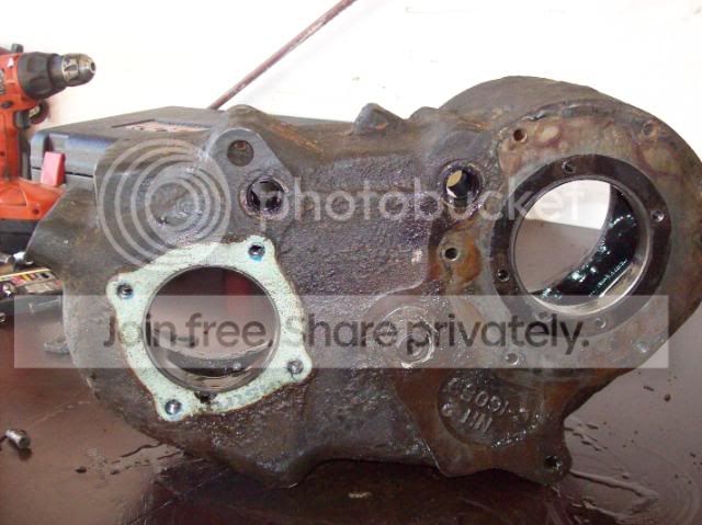

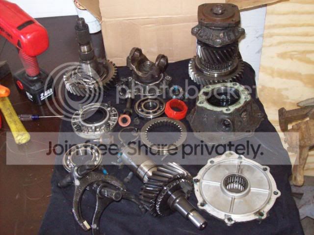

The 241 I got was basically a core.It had a big hole knocked in the back 1/2 of the case from where the chain had broken.All the needed parts for the doubler were still good and for $50 I bought it.
This is all the parts from a 241 thats needed.

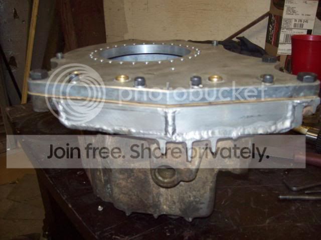

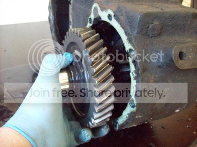

The kit came with no instructions at all,and there is very little info on the net about a 241/205 doubler.So with that bein said here's where I messed up.I ride with a guy who has a 231/300 doubler that was built usin D&D's kit.He said to cut the case along the casting mark.

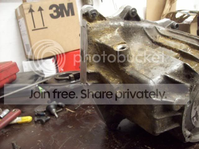

WRONG!!! I know I should have checked before cuttin it but I didnt and it wound up bein about an 1/2 inch short in some places.So that put me to findin another case 1/2.I use to work at a trans shop and luckily enuf he had another one.I assume the 231's are cast a little different than the 241's.

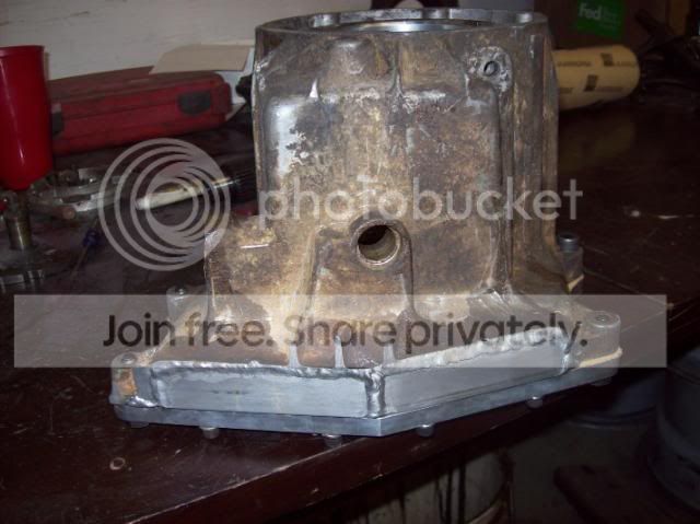

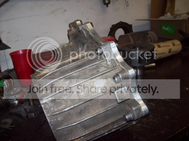

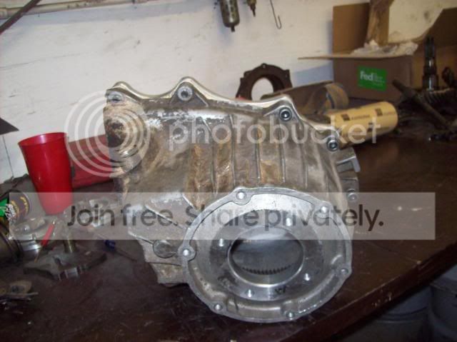

I went and got another case and started over(after takin careful measurements).I used a port a band to cut it.

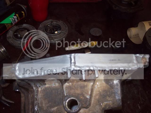

The kit comes with an alum slug to weld in but for some reason I didnt get one and wasnt waitin for it to get here so I used some square alum stock we had to plug the gap.The slug will need to be tapped for the bolts to seal off that end of the case.
Drake spent about 30 min weldin it up.
While he done that I made more gaskets.
I spent about 20 min with a file cleanin it up so it would seal good.
Here's what it looks like finished.

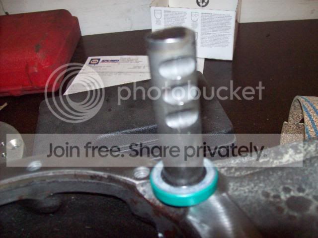

No real work done to it today,but I did get my case back from the machine shop.I had the case bored to accept a seal for the new shift rail.
