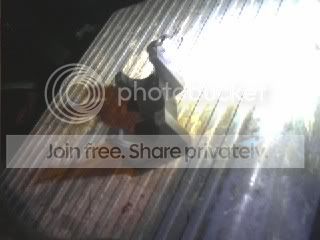

Today, had just got off work, when my rear axle makes a loud clunk noise. Immediately get out, and laying on the cement was a piece of metal that shot through my rear end cover. Can anyone tell me what this is? I looked through the hole on the axle, and the gears look pretty chewed up.

factory gov-loc = traction device.
you now have the updated version called a gov-bom = it blew up. vary comon.
axle will require full rebuild. or better /faster /cheeper yet is find axle same ratio to bolt in and go.

these are worse pics than his :whistle:
