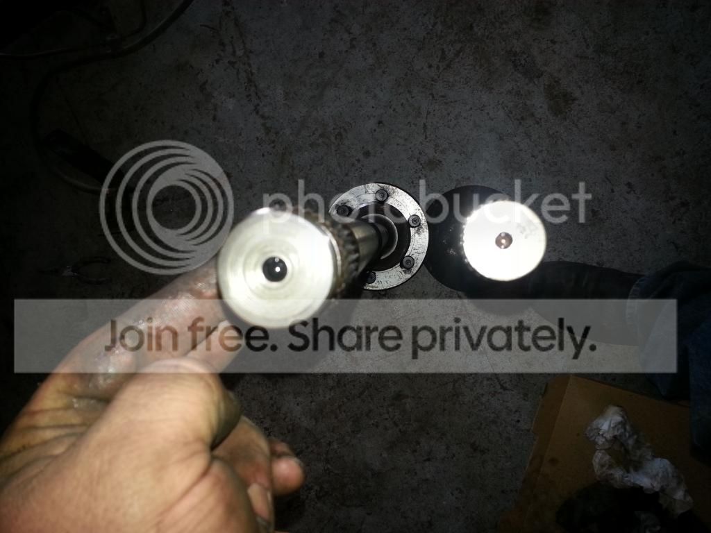

I would suggest going ahead and upgrading the rear axle. You can get a 14FF or 14SF pretty cheap and then just install/upgrade to an 8-lug front 10-bolt axle. The 8-lug 14SF rear axles are usually dirt cheap and easy to find because they are not that popular, but substantially stronger than a rear 10-bolt. Also, going ahead and getting 8 lug wheels means it is one step easier and cheaper down the road if you decide to get bigger tire and thus upgrade the axles.
I hadn't even thought about a 9.5", are they heavy compared to the 10 bolt? I read somewhere that the 10.5" is like 600 lbs. I can move around the 10 bolt in my Skylark myself. When the time comes, I'll see if I can dig up a SF in the junkyard.
I think 10 bolts would hold up for this application pretty well, too. Keep the tires in the 35" range, which would actually look pretty big under an s10.
Only real downside is the rear axles aren't full float and tend to walk out if you break one.
Its a lot heavier... I don't know an exact weight, but when I did the axle swap in my truck I could move the 10 bolt by myself but really struggled to move the 14. This had the 13 inch brakes on it as well, which obviously didn't help.
I'd probably have done a 14ff if I was going to go 8 lug. The only reason I did the sf was to keep 6 lug.
Parts are more expensive for them for some reason. Price out a 14ff and a 14sf detroit and tell me I'm wrong :whistle: :doah:
Plus the 14ff is so easy to re gear.
I am not a fan of the rear 10 bolt. I realize you give up clearance with a 9.5" sf. But the shaft size difference is substantial
