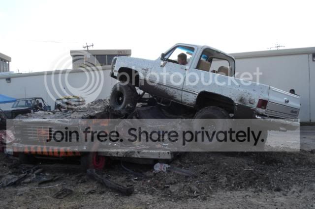

Ihave beefed up 10b. Yukon Axles, Loc Rite locker, 4:10s, all new seals and bearings. I dont wheel too hard but I feel its pretty durable. Im running 33s.
I agree that you do have to know its limits and dont think its bulletproof. be easy on the skinny pedal and you should be fine.
SHots of muah blazer. :D
