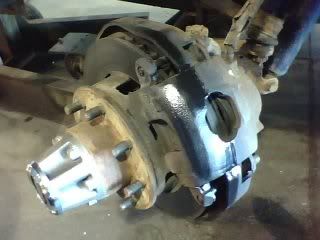

The only thing to avoid on a Dana 44 8 lug is the early three quarter tons with an external hub. Don't limit yourself to a Dana 44 though. Just buy which ever you come across first that is cheap and has 4.10's, a Dana 44 or a 10 bolt.

Sorry for being a small, crappy cell phone pic, but this is an external hub Dana 44. That is the one to avoid, but they so work.
