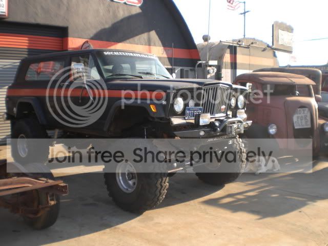

I just want to say that that cherokee is bad ass! :thumb: love the older 2 drs and the old school FSJ grills
Thanks guys... I stretched a Jimmy frame 2.5" and transferred the 74 Full Size Jeep body over to it. It works out well as far as finding parts just about anywhere now. It was a real PITA going into Autozone and trying to explain to Jr. that it wasn't a Grand Cherokee. Its different and it gets used so I like it for those reasons. Its really a Jimmy in disguise.
