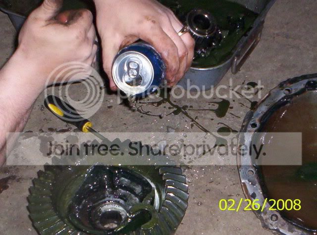

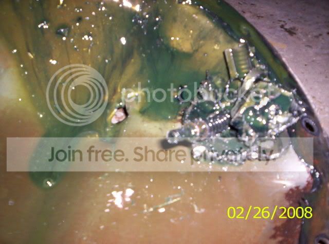

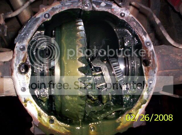

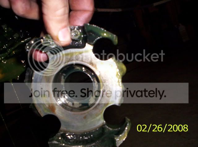

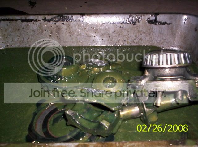

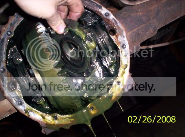

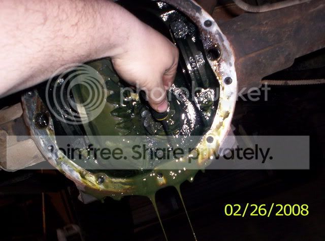

well i know the preaching i am gonna get for this but i GRENADED a 10b carrier. amazingly the ring gear and pinion are not hurt. but i gave 35" bfgs and 4.56s so here is some eye candy

Wow. Hope that never happens to my 10b with 35's. I don't have the money to do an axle swap yet! :D
Pretty sweet carnage.
