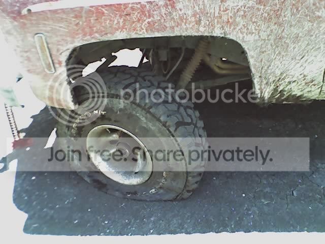

You really should repace them with new ones. I got mine from suspensionconnection.com for pretty cheap. This is what happenned to me for reusing my u-bolts. It sheared the center pin while reversing and shredded the sidewall of my tire. All because of a weakend ubolt.
