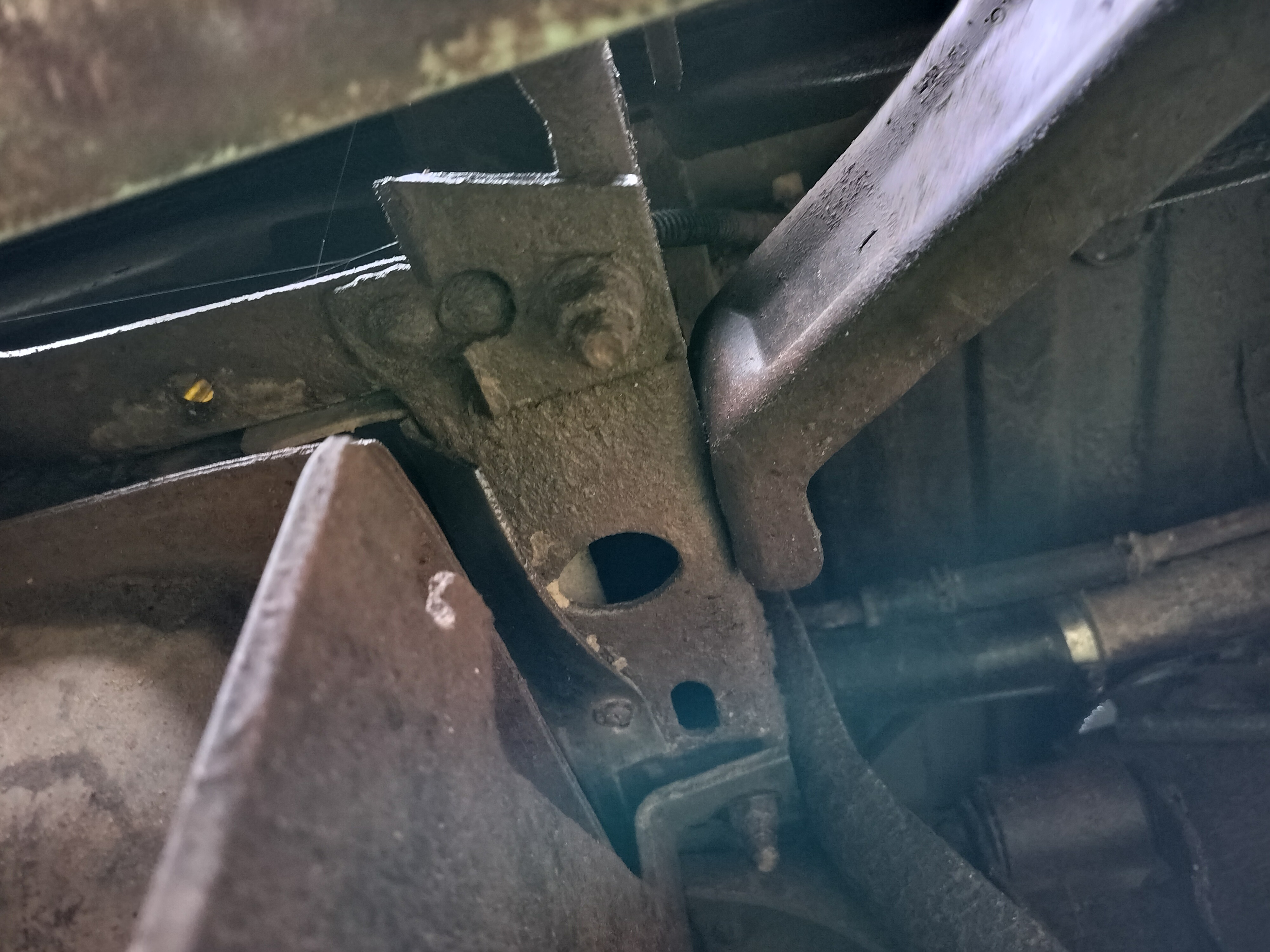

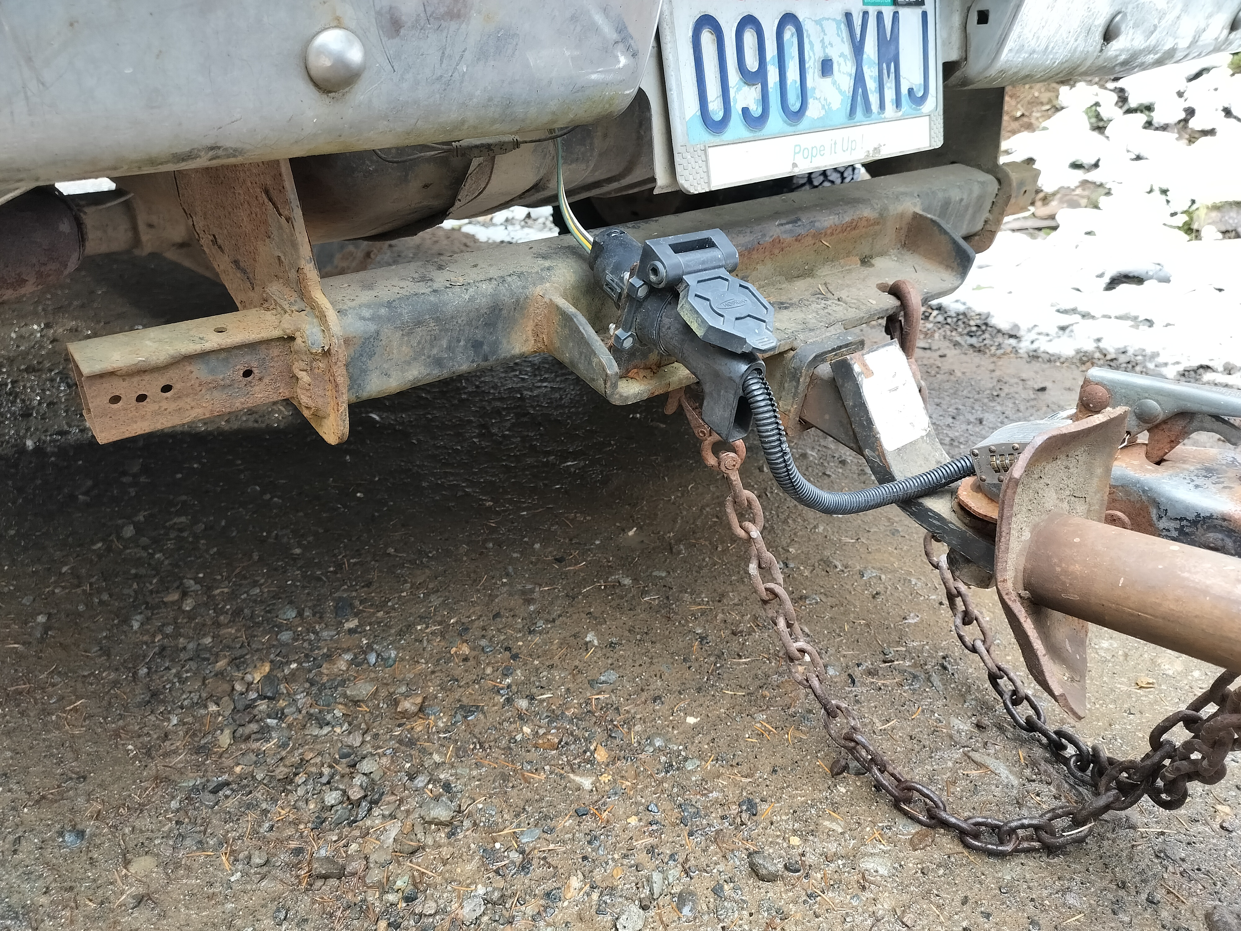

First up, first day, after 100 miles of highway, within one mile of hitting the gravel, I heard a "bang". The trailer is all metal, filled with propane tanks, gas, and diesel, so it's not unlikely to hear some noise as it bounces through the potholes. But this was a bit much. Immediately after I process that sound, I hear it again, so I immediately stop. Figured the problem out pretty quick:

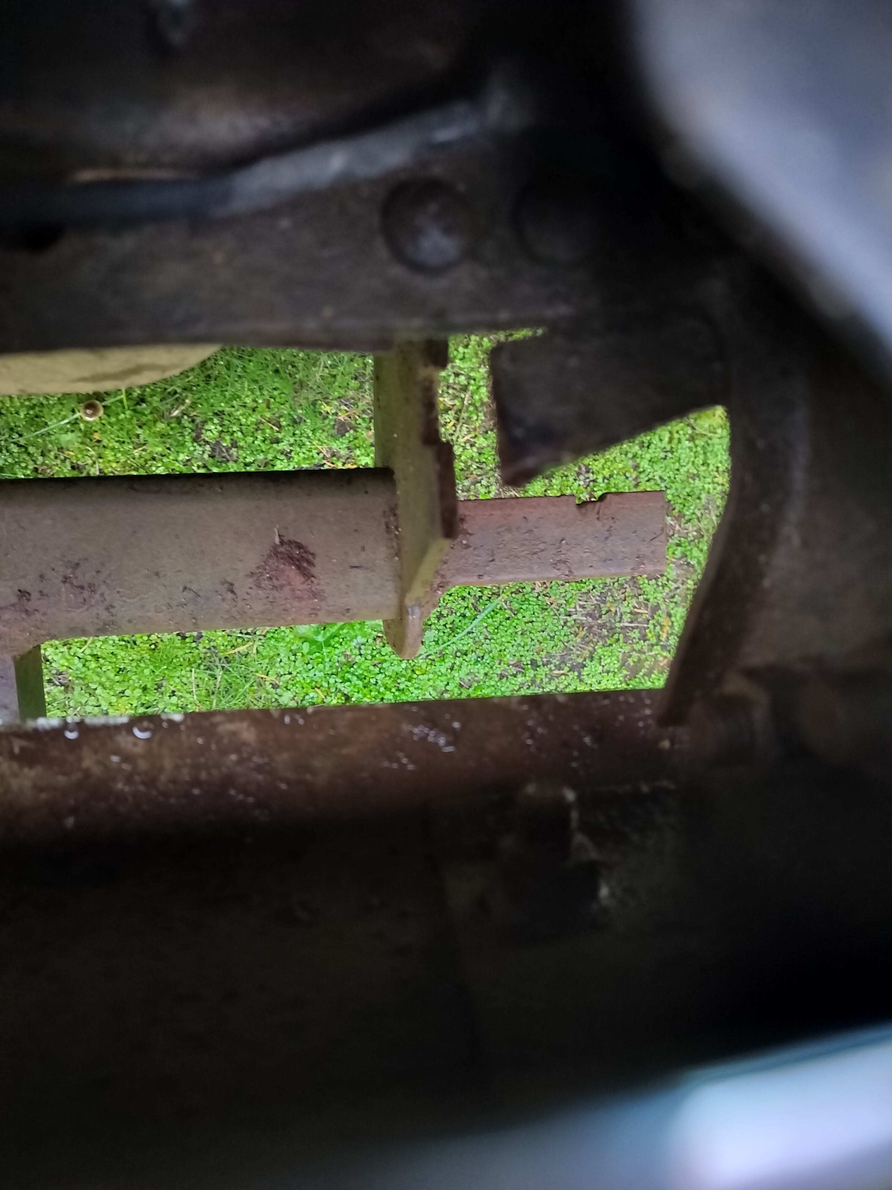

Closer inspection pics, the angle isn't quite as obvious as in person:
Yep, sheared the two rear legs of the trailer hitch. Luckily the two front mounting points didn't shear, so I was able to pull it over in a wider spot and call back for the other rig to come forward (after dropping their travel trailer) and take mine up and over once I had gone ahead and confirmed the weather reports were completely wrong, zero to 1" of snow at most on the road.

Big problem though is the trailer hitch. I think I may go ahead and repair it in the future. I'm not seeing anything but other class III hitches sold, so replacing it with another of same design isn't going to prevent this from happening again. My guess is simply fatigue from both vertical and side loading. I haven't looked at it closely to see whats practical, but small gussets from the bolt flanges to the vertical portion would have prevented the failure at the bends, so when I weld it back up, I'll likely do something along those lines.
