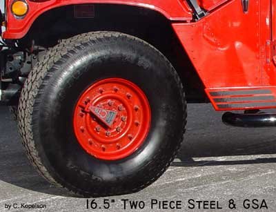

I'm recentering a couple of sets of H1 rims (or having it done actually). The 12 bolts have the mounting surface on the fronts, not the rears like the 8 bolts. So, my question: should I cut out to the inside of the ridge on the fronts(leaving a larger beadlock ring and a ridge for added strength) or to the outside (basically making them look like 8 bolts do, but with 12 bolts). There's no doubt in my mind that leaving the ridge will add lateral strength and still allow me to get to the lugnuts (the center welds into the back like normal), but will it look stupid? Opinions?
Here's a picture of a 12 bolt that I found on the net so you know what ridge I'm talking about (the one to the outside of the lugs, but to the inside of the wheel half bolts).
