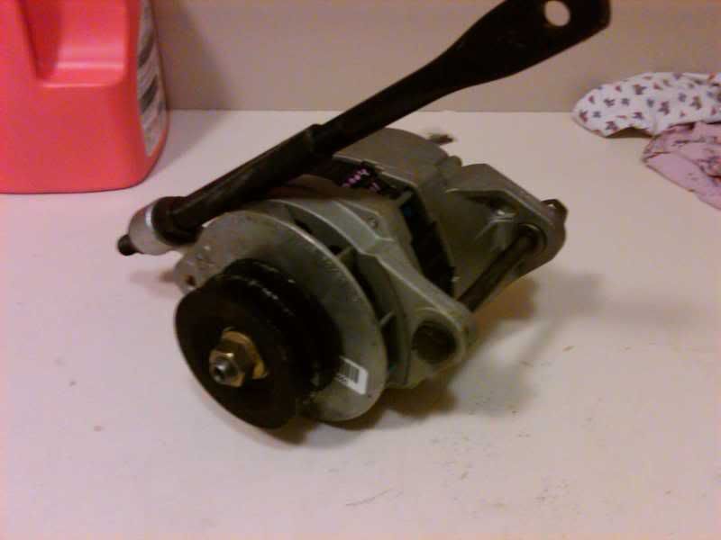

AFAIK, my '82 is using a 3 wire 10SI alt...
Can I replace it with a 12SI? Found one at a good price.

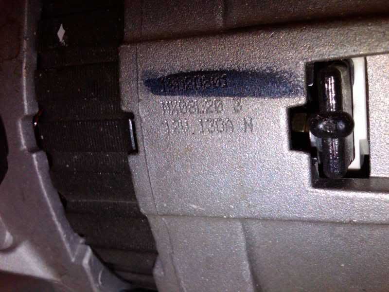

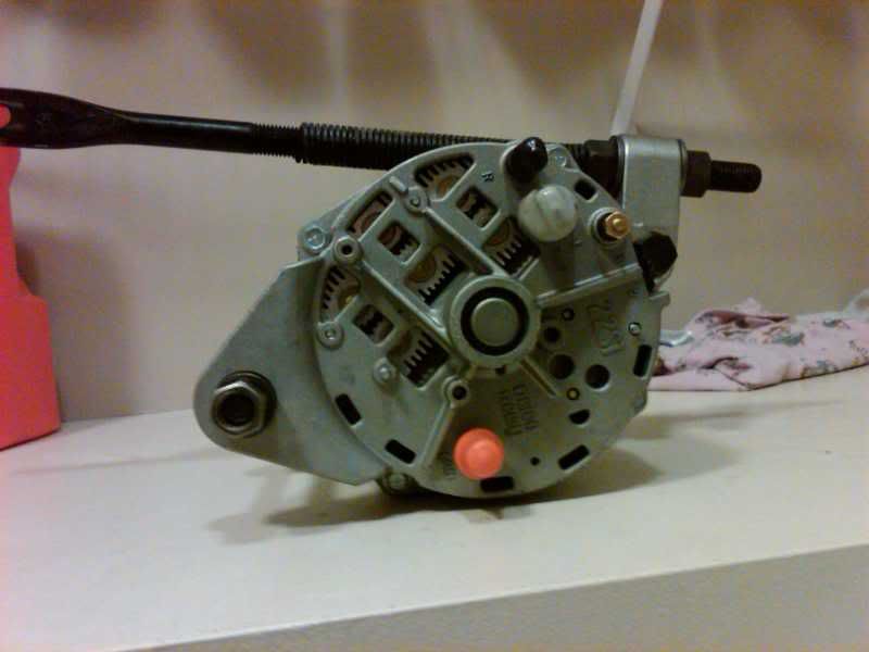

I wonder if mine is a 22SI too
It looks the same and it was remanufactured and supposedly uped to 135amp, I am going to take a look at it.
You can tell by looking at the fan of the two units easily from the front:
10SI
12SI
That sir, is damn near the extent of my alternator expertise! HA HA!
This page gives a rough idea of the upgrades a 12SI has over an older style 10SI:

I know that much, it's the 22SI I am not familiar with:D
I have 12 of each sitting on my shelves I was looking at them today, trying to clean up so i will be testing and throwing.:doah:

the 22si I got was OEM on a Series60 genset. I was going to upgrade the Alt on my 12v cummins with it. But I found a 160amp Leese-neville instead.
