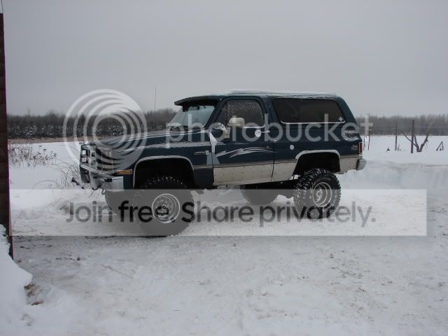

The last couple of days when I try to move the vehicle the driver's side rear brake is frozen. We have had a lot of snow and some freezing rain. If I rock the vehicle I will hear a clunk then everything works perfectly. I searched but could not find a relevant thread. Is there a solution to this problem?
