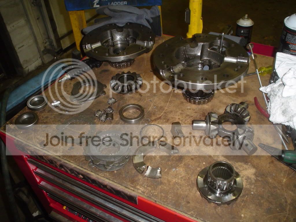

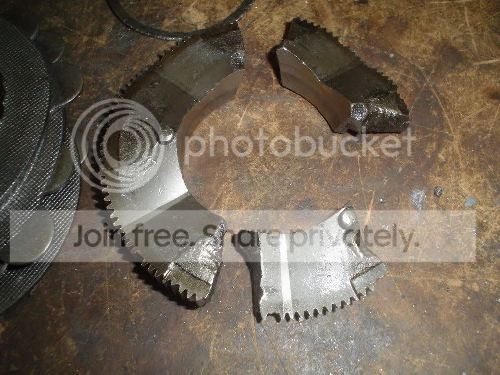

My 14boltFF gov-loc cratered just over a month ago. I heard they were strong too.......its bullsh*t.

I know I know. I still drive it. It's locked up tight like a spool........
