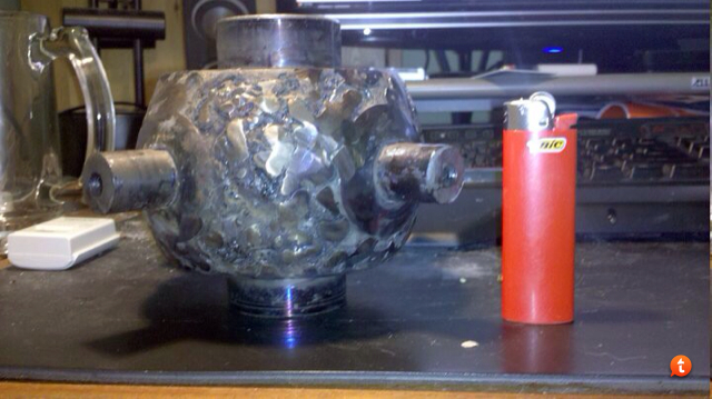

14 bolt mini spool
Orb of traction for the win
How are the spools/orbs in a 14b with 37" tires?
