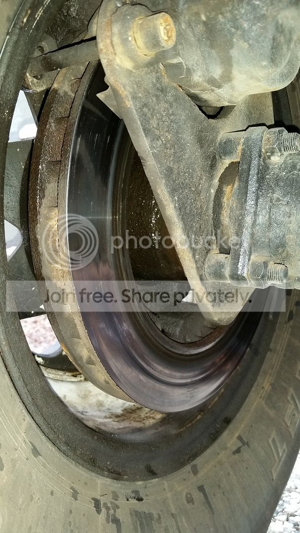

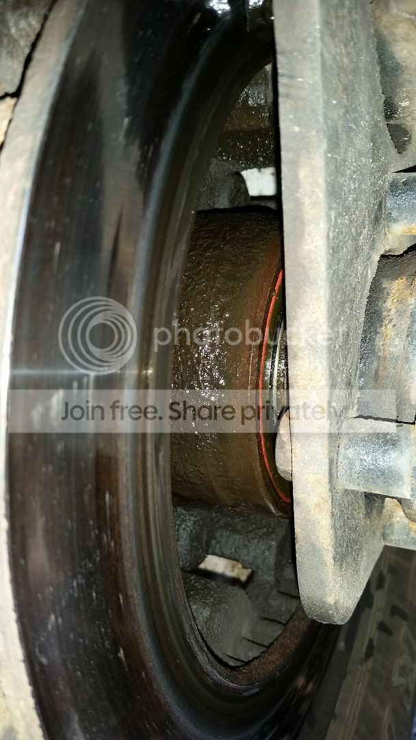

No not there, there is a gasket there. I'll post some pics.
that position is called wheel seal .
if there is a grove on the seal riding surface it needs a speedi sleve . or better yet the newer style seal in a seal style that dosnt spin on the axle seal surface but spins on its self .

I would replace it. The groove in the spindle has likely nicked the rubber, even though you probably can't see any flaws. Better safe than sorry.
old trick also red loctight on the seal area before speedi sleave .
and I have just tapped it on slow with the back lip and been fine .
also the big cup the sleave come in the box in works great as a axle nut socket storage cup in your tool box to keep grease / oil in the cup .:D
