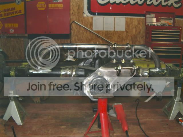

mine:

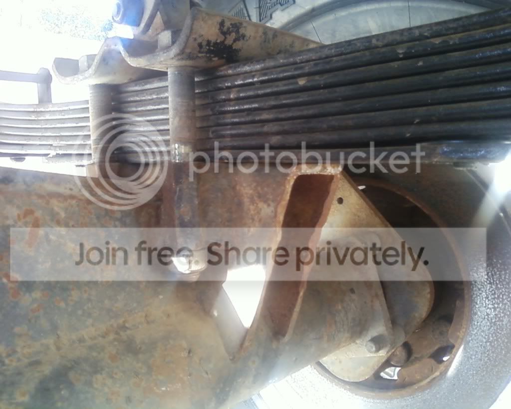

I'm currently cutting the perches off and setting them back down directly on the axle tube instead of on top of the truss, my new springs provide the height that I need, so I no longer need the tall perches.

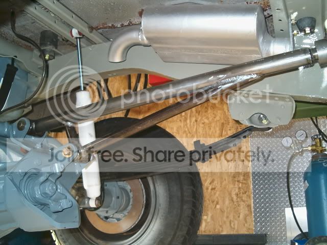

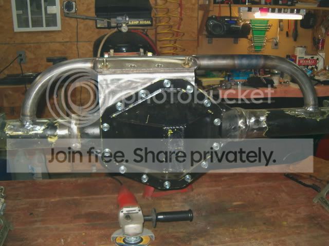

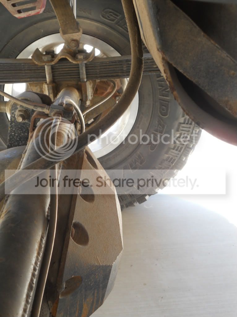

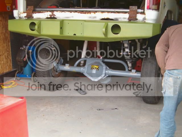

I use a BTF truss with integrated pinion gaurd for my upper link mounts. I like the look of Artec's full width truss with pinion mount too
Kerts, DIY4X backbone truss and antiwrap setup....let me tell ya it works great!

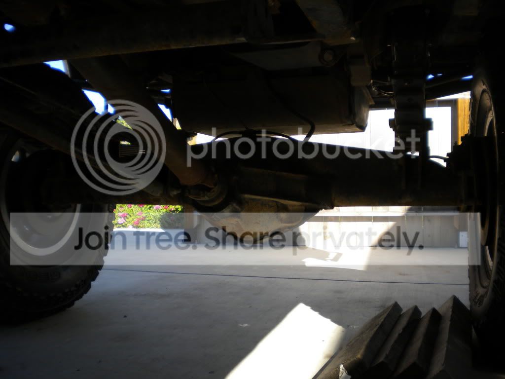

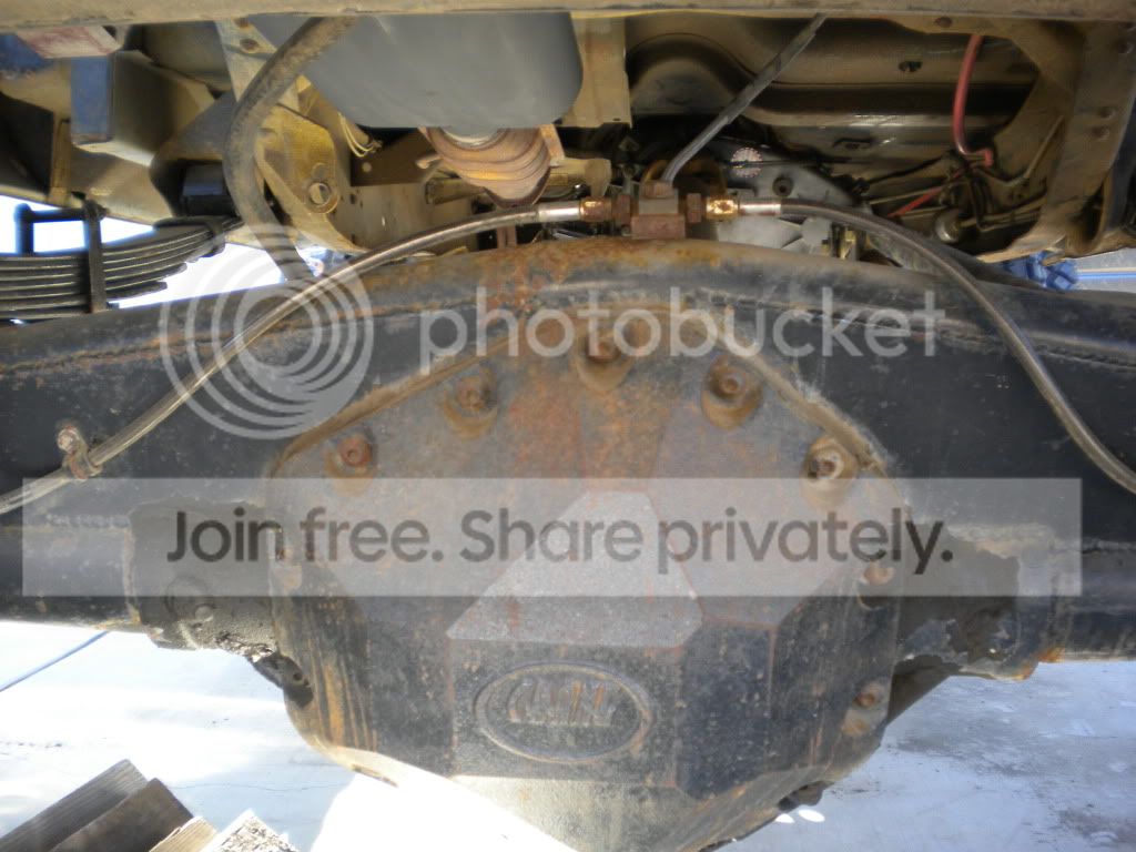

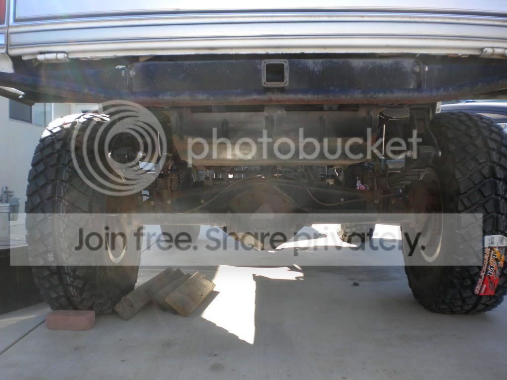

I like the 76zimmer's support, with a few exceptions, I have a creek that I have to drive through (its the road) for the first 1/4 mile of the property. I love the idea of a solid square tube reinforcement on top welding both of the axle tubes and the pumpkin together. Down fall is that water would get in there and rust it from the inside out, and of course with Murphy being the bastard that he is, I wouldn't know it until it was too late (it broke). So I think I will incorporate holes in the forward and rearward faces of the reinforcment structure. I imagine that you feel everything that is ran over with how solid that rear end is. I also like the fact that the brake lines are what I think are hydraulic lines, excellent idea, but where the lines are secured to the face of the rein that is where water would get in too. Is that a shaven housing? I don't think I need to do all of that, then again, it would give me a few more inches of ground clearance off of the stumps. Haven't given up on shaving the housing, biggest bitch is chucking it up on the lathe at my shop. Probably just make up a fixture and bolt up the gear to it then instert the fixture with gear attached into the laythe and spin away!!! Yea, I think I'm going with a shaven housing too!!! You guys are awesome!!!
I like Artec's stuff, just not enough structure in the middle, I mean the housing isn't attached with the exception of the axle tubes. Just doesn't sit right with me. If I put a **** load of weight on it I don't need the housing to get in a bind, all it takes is just a bit and blammo, there goes everything. They do have a good idea, just wasn't followed through all the way.

imo its best to get a truss that ties into the pinion or diff cover. Have seen a few untrussed ones spin axle tubes. You can weld the tubes but if your doing a truss just tie it all together.
ditto Matt, I had good luck with mine so far, rather crude as others may have wanted a more ideal setup for welding it, but it worked out great, and hasn't cracked yet.
