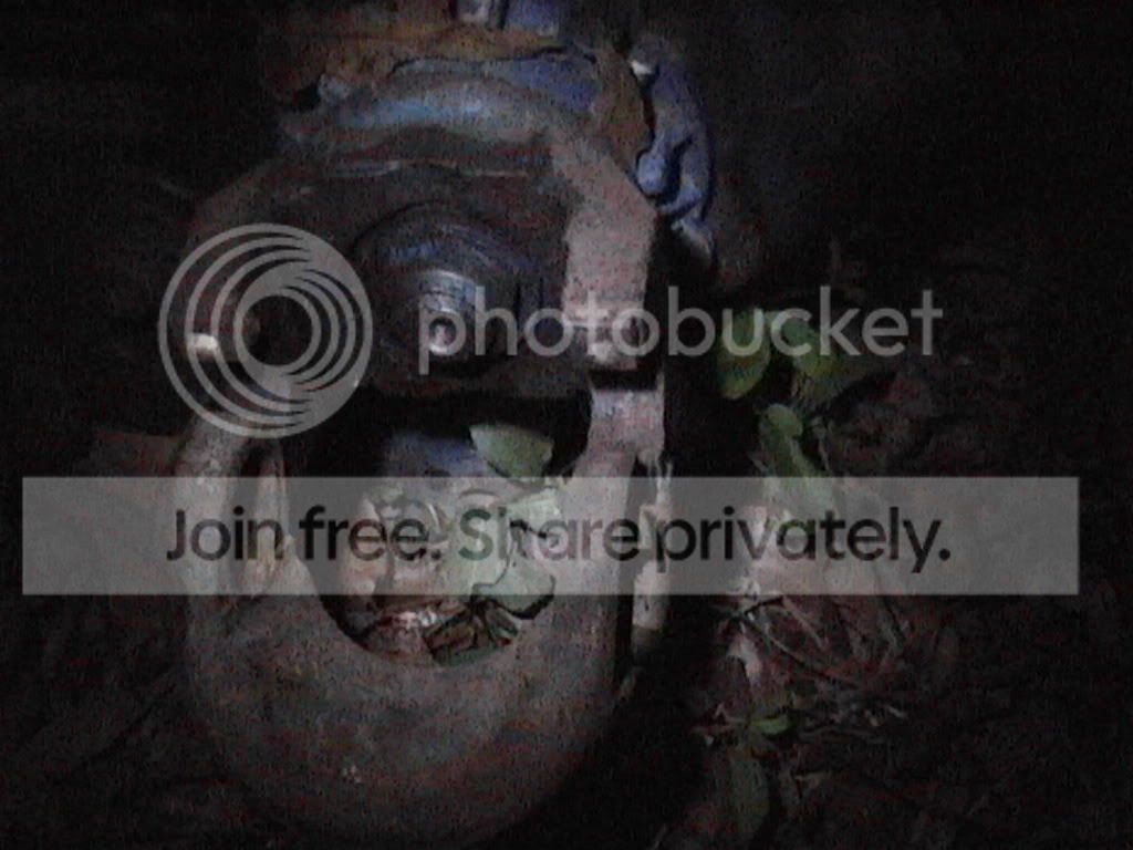

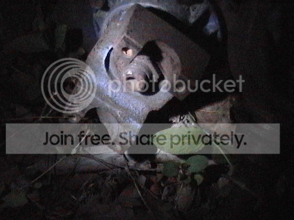

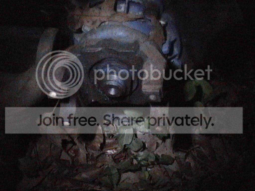

i have a set of 1410 old style (stock) 1410 yokes on a divorsed 205...i want to use them for now (strap not u bolt style) anyone have a napa part number for the 1410 u joints with the inside clips???
some pics i found
next to a d60 stub
Why Napa? and not spicer? It has been my experience that I have broke almost every after market ujoint except spicer. I have found that it is cheaper in the long run to pay for the spicer joint than to replace a broken one and the yoke it took out with it
Just my opinon.
Are you sure that's a 1410? Looks like a Detroit 5380 joint probably from a Dodge. Measure the hole where the cap goes, if it measures 1.232"ish than it's a detroit, if it measures 1.188" (same as a 1350) than it's a 1410. Where it has no locating ears it has to be a detroit as they use inside snap rings and Spicer uses outside snap rings on all but their wheel joints. A 1480 wheel joint (332) has 1.375" caps.
You could use a hybrid joint, they are fairly available if you don't want to spend the money. The two joints are comparable in size.
