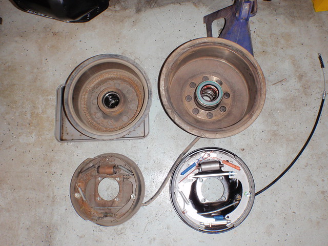

I went back to drums on my other truck. It's a crewcab dually with the 13 x 3.5 drums, and you know, its stops beautifully and the parking brakes HOLD.
Disc conversions are lighter and easier to clean and such, but aren't the endall to human existence some folks make 'em out to be.

Those calipers weren’t worth the crap when they were on its indigenous species of El Dorado, Riviera and Tornado. I get it why people want to swap to rear calipers to shed weight (or maybe because people read too many bolt on build threads) but if you want to stop and have a park brake that actually works like it has an auger drilled into the ground , big 13” drums are the only way to go…. or swap in a complete donor disk brake axle from a Silverado HD or RAM truck, which even those too have a little brake drum inside the rotor. Caddy calipers are undersized for a large truck to begin with then the added expense of adding a driveline brake or line lock makes the bad idea of a Caddy caliper swap even worse.
I’ve been wrenching and wheeling over 25 years and you can bet money you probably won’t see anything on the rear of my rigs other than drums…or a swapped in Silverado axle if there is a moment of weakness. These are 13’s compared to 11’s as I swapped on bigger brakes a while back. Yes, they are heavy but they stop and hold an 8,000 lb. truck with ease. Just like a semi (notice most new class 8 trucks still run drums?)

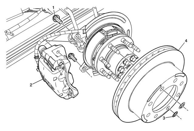

If one must have rear disks, this American Axle design used on the Silverado and RAM is well done but it is not a swappable setup outside of doing a complete rear axle. Although, wasn’t some fabrication company working on way to swap this on to older axles?
