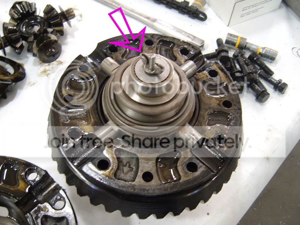

I'm going to be re-gearing soon and I can't find my box of misc gear stuff :doah: (I recently moved...) it had the bolt & washers that holds the detroit locker together for installation into the 14BFF. anyone know what size they are so I can go to the hardware store and get a new one?
I can't remember the length but pretty sure it was a 1/4" diameter. Pretty much it just needs to be long enough so that it reaches from one side of the locker to the other with a washer and nut on the ends obviouly.
here's what I'm looking for...bolt length & washer size would be nice...I'd like to have it ready to pull once I get the carrier removed, but I can always measure it then run to the store, I just like to have all the stuff on hand 1st
The shafts are 1 9/16", I made one using 1 5/8" washers that I had to grind down a little. As for the piece of allthread, I don't remember, 6-8" maybe?
