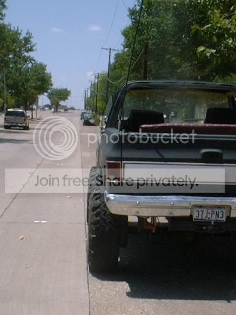

Van width rear on my blazer. It is now even with my front. Normal 14ff's are not as wide.
so basically, if i get a 14bff from a van, it will be the same width as a d60 front with srw hubs? are the spring mounts and shock mounts the same on a van as on a k5?
p.s. the pic you submitted answered exactly where i was going with this thread.
I have a SRW chevy d60. Van width 14ff. The rear perches and everything where not on it when i got it, so it was all replaced. But the 60 and 14 are just about even, or atleast very close. And i have 15x10 rims with 2.5" of backspacing. thats why they stick out that far....
