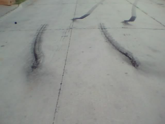

He installed mine for me (I had to run to Wal Mart to pickup some axle grease, it was the only place open at the time), when it was done, I backed out in front of his shop and did a burnout. It has been beaten mercilessly since then behind my tired 454/SM465/NP205. It always spins both tires, and I beat it like there is no tomorrow.
