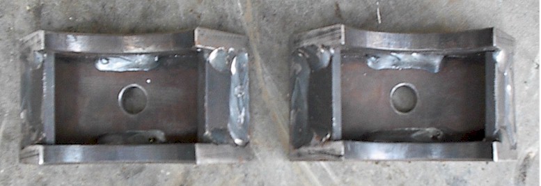

I made my perches....very similar to this article.
I just took two 5" long pieces of 2.5" X 2.5" X 0.25" wall square steel tube and traced the half moon shape onto the steel. I drew up the perch full scale at work using my CAD software and just transfered the shape to the steel. I then used a gas-ax to cut the half-moon out and then clean it up with a ginder.
I then cut some caps out of 0.25" plate and boxed the ends, drilled the alignment hole and was pretty much ready to weld them on the axle. Total cost...about $5! /forums/images/graemlins/thumb.gif /forums/images/graemlins/thumb.gif

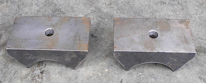

I make the occasional set as a favor now and then. I can't really sell them because I'd never make a cent on them...too labor intensive. I just finished a set for FWP and I prolly have over 4 hours into them plus machining. I don't gas-ax em out of tube though.
To make them affordable they have to majorly mass produced or you have to suck it up and build them yourself. $46 is quite a reasonable price, and I bet Mike isn't making much on them either.
These are the ones I did for ftn96 a couple years back.
FWP's are similar... /forums/images/graemlins/thumb.gif (they'll be on their way by Saturday Fred)
