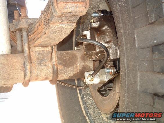

took me just 2hrs... i have the az-kickin.com kit (they arent around anymore) and I love the kit....
I removed my studs with a big bolt and BFH!!! worked great... banged them out... put everything together as needed... and banged the lugs back in... was easy.....
shame az-kickin doesnt make their kit anymore... cus for $80 for the brackets and $50 for the hardware kit.. hardware kit was 2 brake lines (chevette lines around me were $30 each so there is more than $50), connectors, bolts and I liked the way the brake adapter bolted to everything...
I went with d44 calipers but went with eldorados later.....
