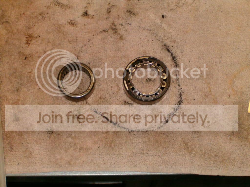

These are the 2 different types of front pinion support (gm calls it a straddle bearing) that reside in the axle housing. The id is the same, so if replacement is necessary, you just need to know what type bearing you need.
The one on the left is the later style (85 era), the one on the right the early style (70's) I'm not sure where the break was though.
And mind you this ISN'T the bearing in question that is different for the 87-earlier versus 88-newer.
so the question by the OP is for the middle bearing, of the 3?
