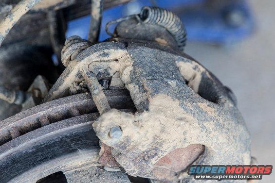

I did not know there is a right and left caliper... they are on and they work. E-Brake don't hold worth a damn... so with me swamping my truck, I had mud caked everywhere and still cleaning it out. Hard peanut butter mud.

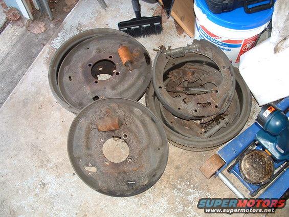

what you are left with... heavy pieces of crud

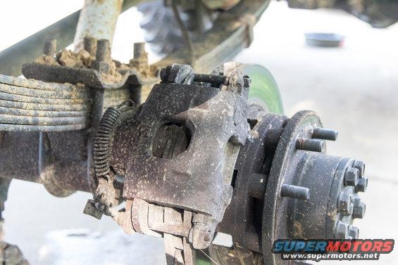

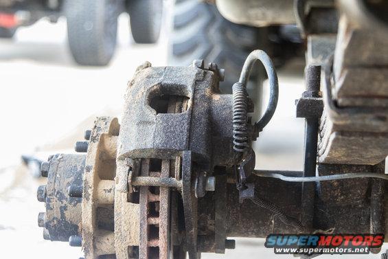

brake pics with tires off - taken 8/30/17
left
right
so my first question
Do I have the Left and Right in the right spots? How do you tell? are they marked with L/R?
I figured bleeder up and springs inside so they have to be right???
2nd Q.
Is there an aftermarket ebrake bracket to hold the cable?
left
right
2nd Q.
