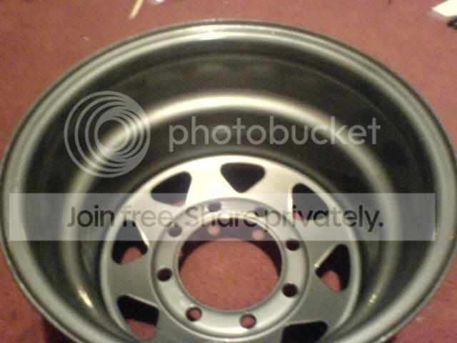

i bought mine from summit in bare steel & had them powdercoated, they called the color anthrcite, but it looks like argent, but about a shade darker. i've had alot of coplements on them. here they are:
they have 2.5'' bs, so they would clear the calipers w/o grinding, i got them b/c i already had a set or 44/18.5/15 tsls w/ 1/2 tread left, when they wear out i'm going w/17''s or 18''s if more tire selections come out in the 18'' sizes.
I'm not sure I would want to stick the wheel out that far. Shorter the backspace the more the wheel sticks out, farther out the bigger the swing is into the floorboard and front fender or wheel well. Adding beadlock adds another inch...
