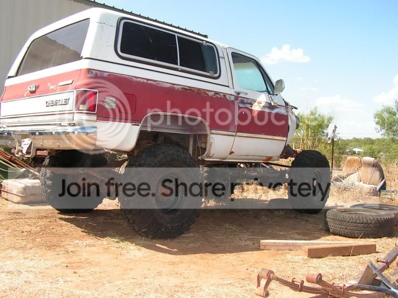

Hey Guys,
Will 15" wheels fit on a 14 bolt ff? I know you can grind the calipers for Dana 60's, but was unsure for the 14 bolt rear.
Thanks,
Brent
1000 words worth
4" BS
I run 4.25" BS steel rims on a 14ff with the stock drums so yeah they'll fit discs like howdiy pictured as well as drums.
