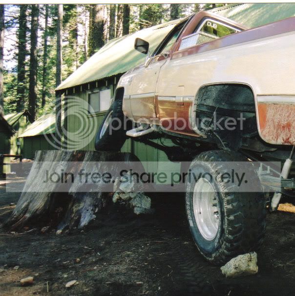

here are 40" MTRs on 17x10 wheel I believe are 589s or that style anyways.
MNorby,
What is your back spacing and how far are they sticking out? What is the actual posting size of your 40's? ??x40x17.
Thanks,
Manny
I haven't measured the BS yet. I scored those tires/ rim used (for $250-ish) so not sure. They are some worn down but not terrible.
17 x 10 with 4.5 bs. 8x6.5 lug pattern. 35 x12.50 Pro Comps.
