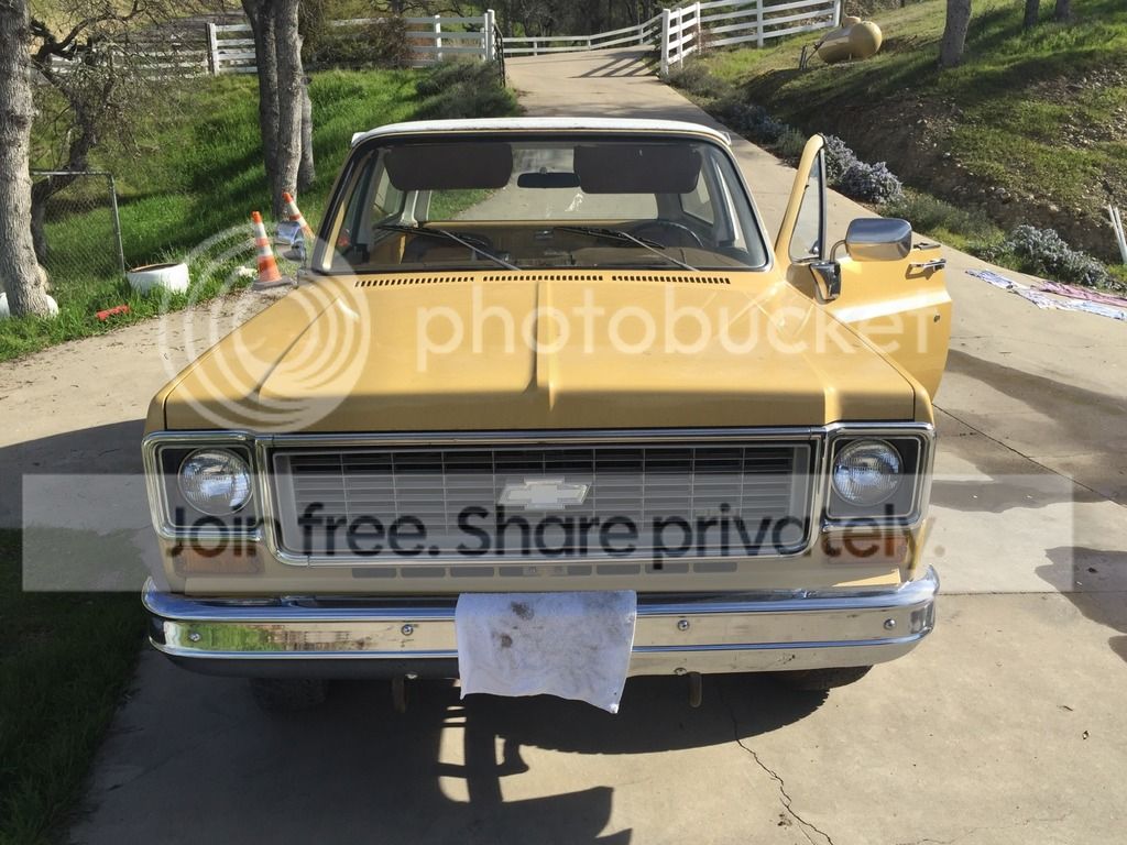

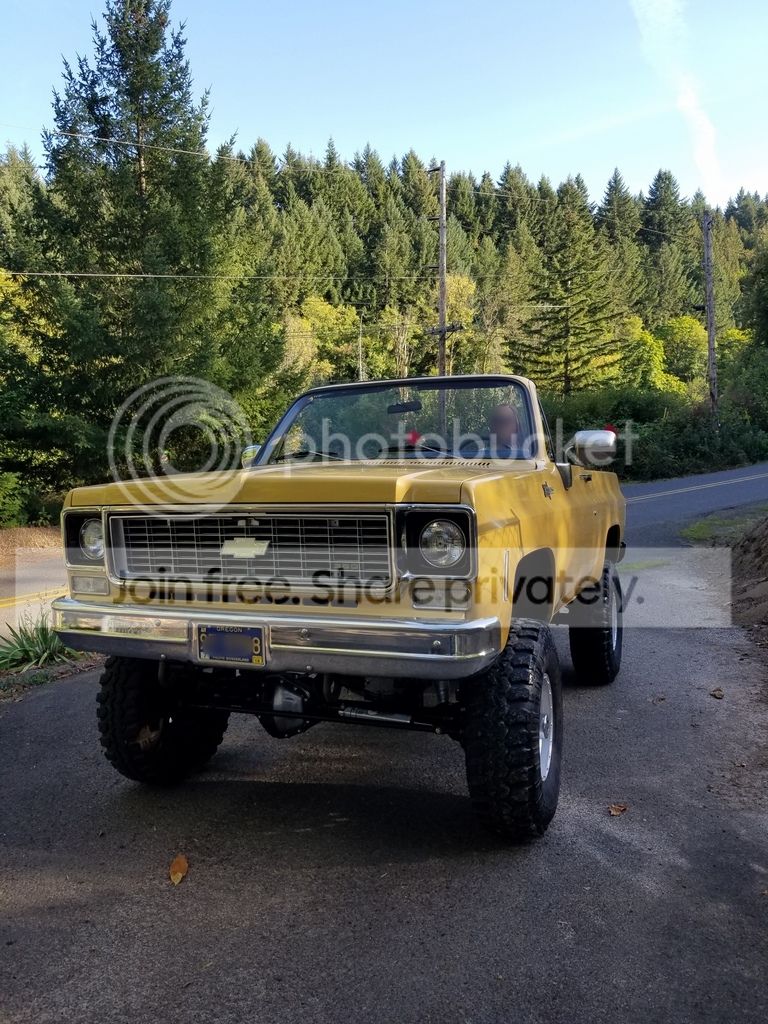

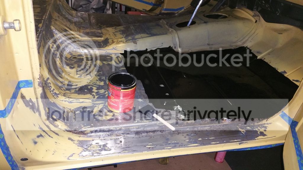

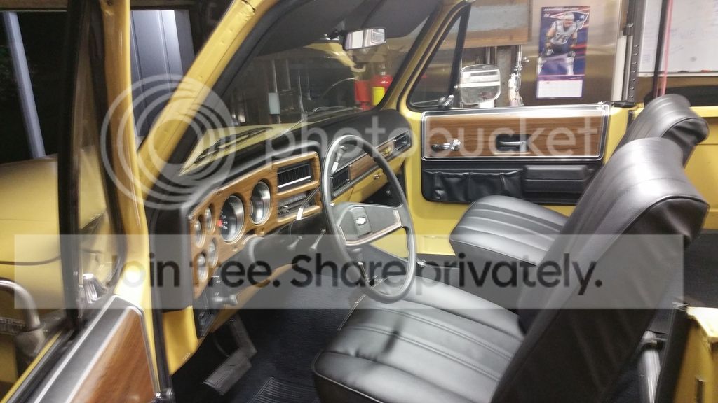

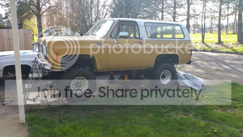

After 5 months of trying to track down a 73-75 Blazer, I finally found one outside of Sacramento up in the hill that was pretty much unmolested with very minimal rust. After a 24 hour road trip with my wife on February 14th :grin: we finally brought it back up to Oregon.

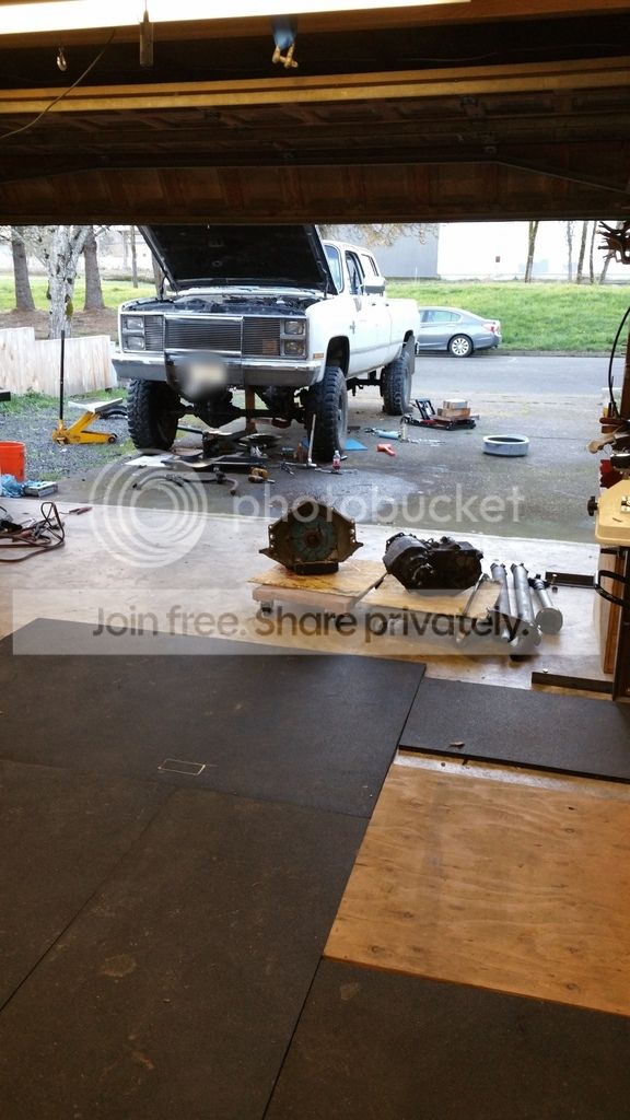

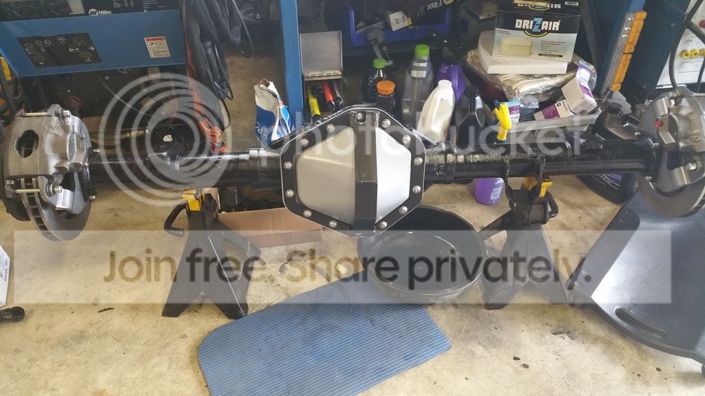

During the hunt, I bought a 86 K30 to swap in the Th400/205, D60/14bolt and the tires/wheels into the Blazer. The wife wanted nothing to do with the manual trans in the Blazer :burnout:
I pretty much worked on this thing every free minute that I had so I could complete it in time for the summer months up here in the NW. After about 4 months I finally got her running in June this year and man what a blast this thing has been. Only complaint I have is that I don't live in Arizona where I can drive this thing year round...
Here are a bunch of pictures throughout the process of redoing most of everything.

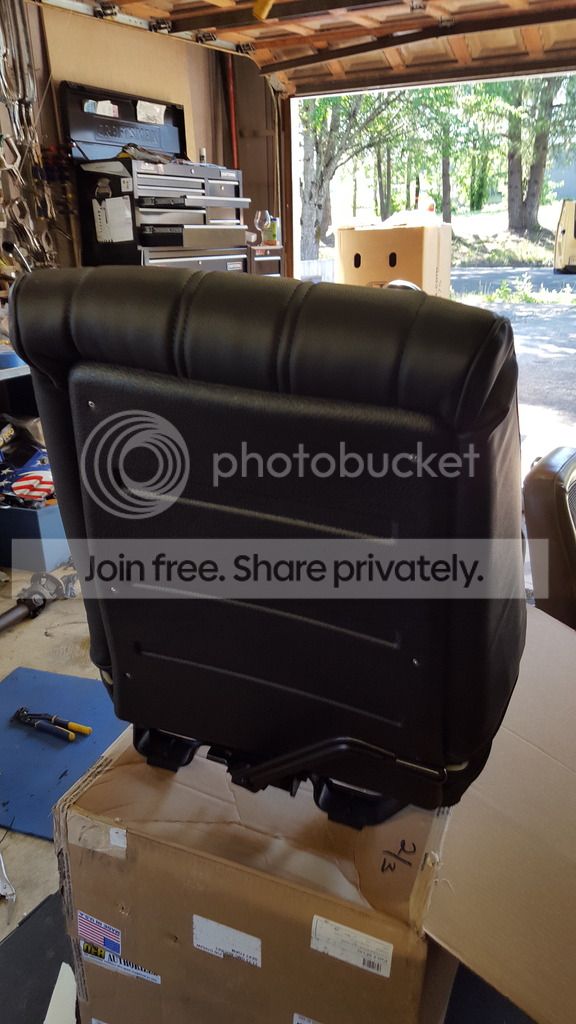

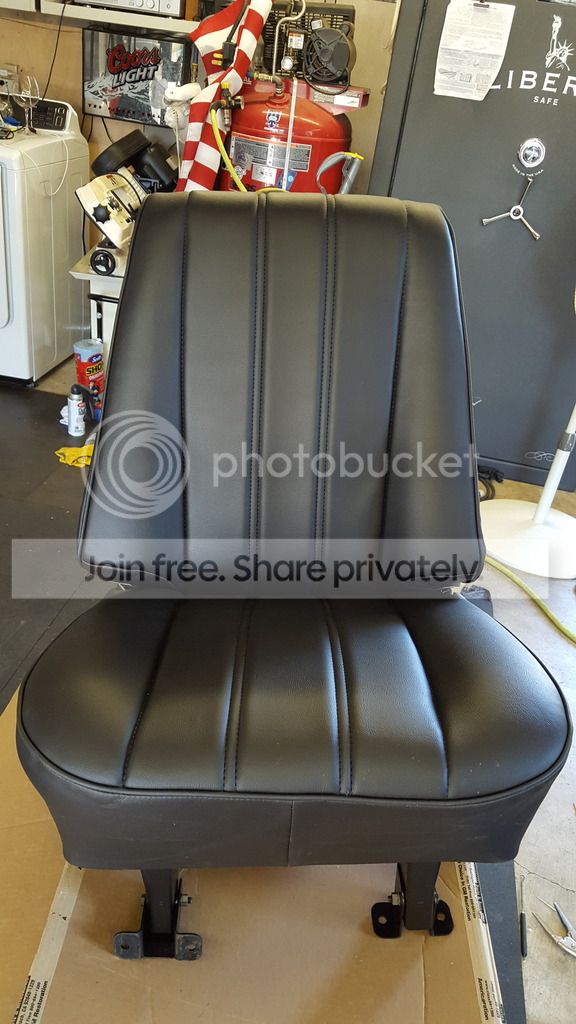

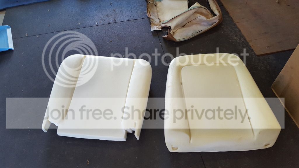

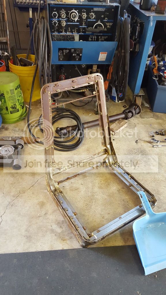

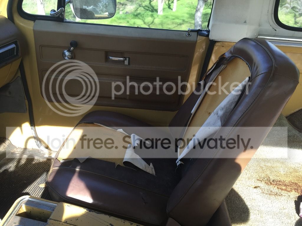

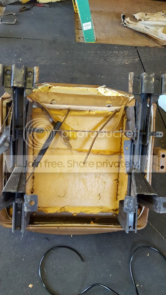

Seats came out great! What sort of structure holds the foam in the middle? I thought there were wires or strings woven in some kind of grid across the seat pan and backrest areas? :dunno:
-G
-G
On the back side of the seat there is sewn in loops along the vertical seams. You run some steel wire through the loops ( I used some .120 SS Tig wire) As you lay the seat covers over the foam, you start connecting the hooks to the rod in the seat cover and pull it through the foam to latch onto another piece of steel rod on the back side of the foam. (Probably one of these toughest things I encountered working on. Another set of hands would of made this much easier)
If you look at this picture you will see the 2 vertical wires and if you look closely you will see the hooks attached to it.
That turned out nice! :waytogo:

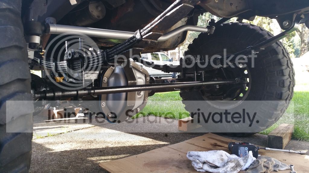

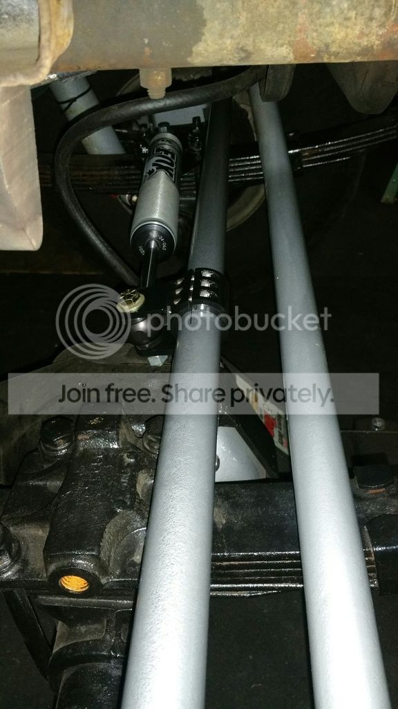

Since work has slowed down a bit I have finally been able to devote some time to the Blaze. The tie rod ends were starting to take a dump so I ordered up the matching driver side high steer arm from Sky manufacturing and the tubing/ends from Ballistic Fab (:poo: Don't do business with them) I also made a mount that attached to the spring plate so the steering stabilizer can be mounted to the tie rod.
