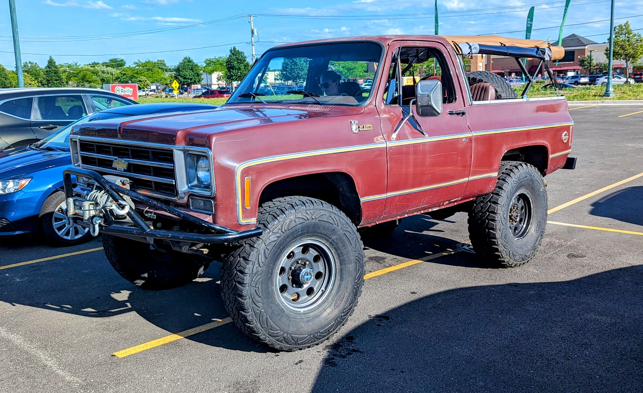

As I picked it up in June:
So far I've started work on fixing the many leaks as almost everything but the brake lines had a leak. Worst was the rear axle seals, but I still need to tackle some other areas before my driveway will stop gaining new stains.

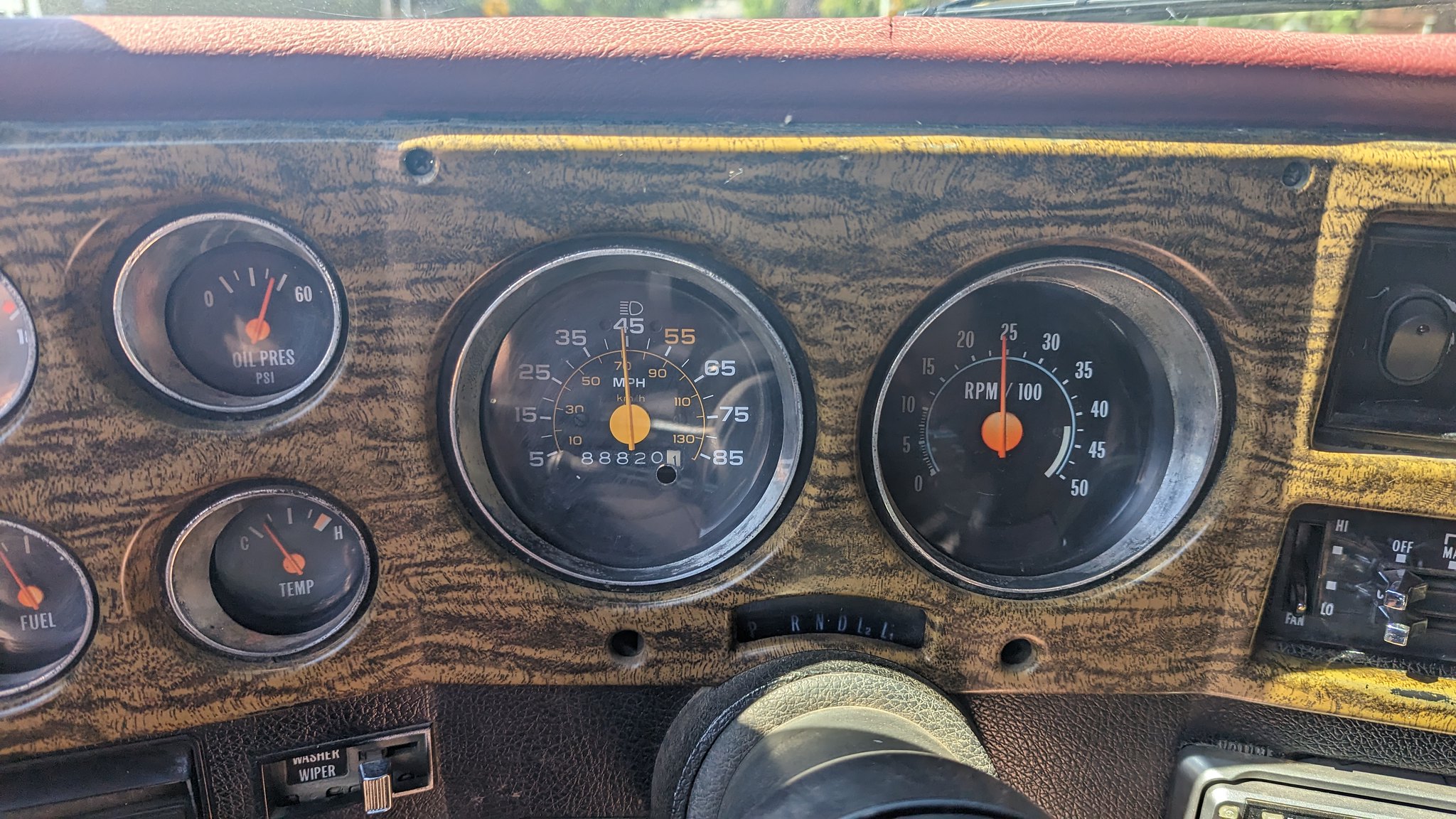

- Fix gas gauge (only goes up to 1/4 at a full tank
- Fix tachometer (reads at least 50% fast)

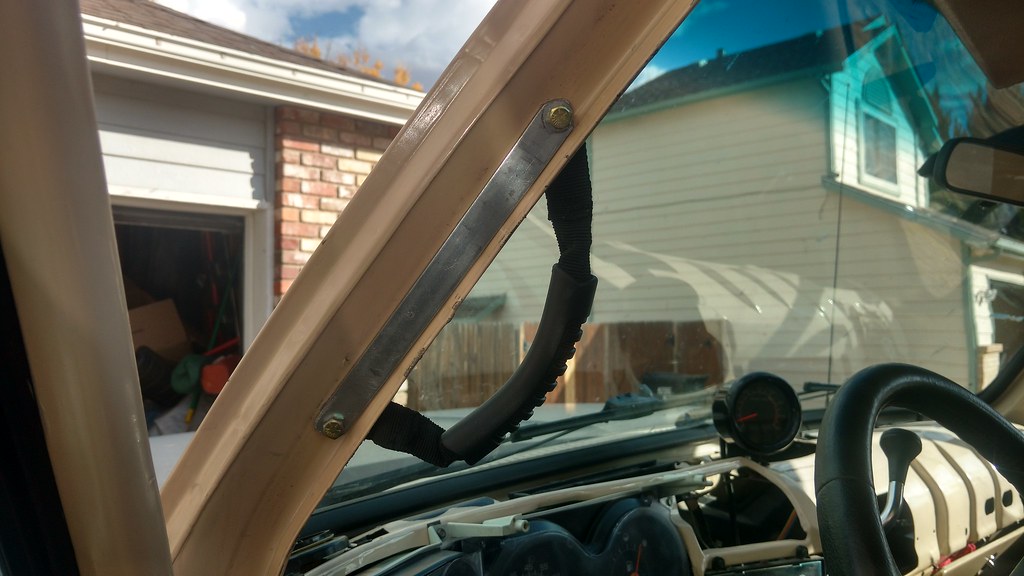

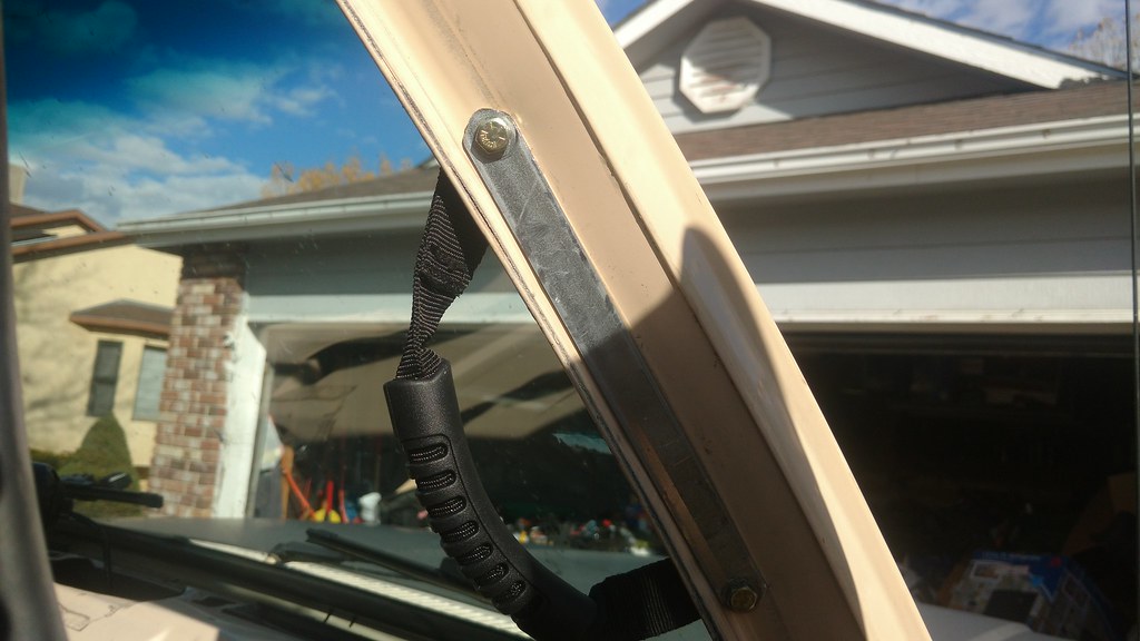

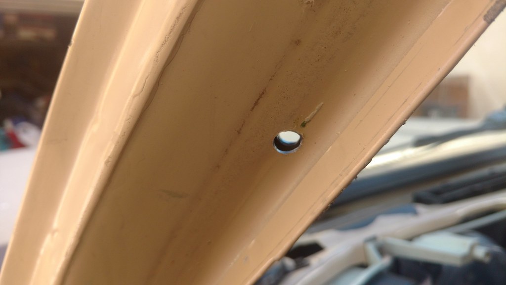

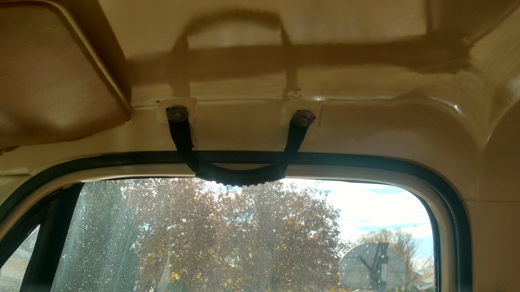

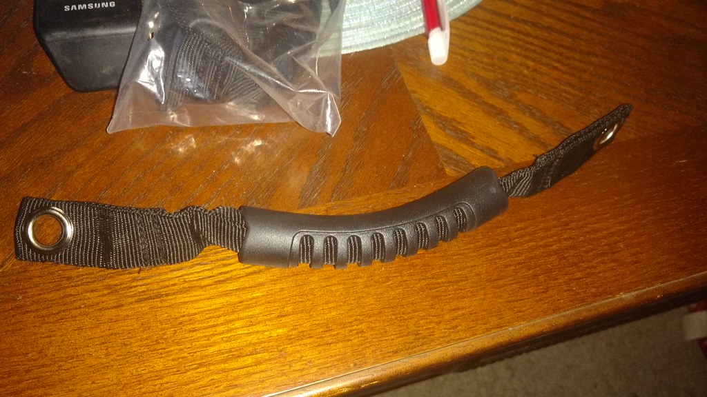

Photos are on my Flickr account. But the solution is pretty easy. Just get some basic grab handles for a Jeep made out of nylon webbing. A quick trip through the jungle website will net solid results. Ideally, you get some with the metal grommets to avoid the nylon webbing from tearing through the bolt.
Step 2. Punch some holes in your a-pillar. It's been a while but I think I used 7/16" grade 8 hardware (because I'm a big boy). The spacing is purely up to you. Too far apart and the handle has no slack to it. Too close and it bunches up. Let your eyecrometer be your guide.
Step 3. Reinforcement. I used some 1/8" flat stock drilled to match the holes. My reasoning is you can see how thin the sheetmetal is when you drill the holes. Plus did I mention I'm a big boy? It's just a little support, but it's held for a really long time in my rig.
The other side is a matter of lather, rinse, repeat. But for your own inner ocd, please make an effort to put the holes in the same place side to side so they match.
If you managed to get a 4 pack of grab handles from Bezos, you can put an extra one up on the passenger side. My '91 had existing threaded holes in the roof for a factory grab handle. I added some oversized fender washers to ensure the handle didn't pull over the bolt. Though, mine is a cheap base level Cheyanne truck so no fancy headliner to hide this spot. If yours is a Silverado trim level you might have to pull the headliner down to see if you have the holes there if there isn't an existing grab handle already there.
My ex was barely 5 foot tall and my truck is sitting on 35's with 4" of lift, so not nearly as high as one on 40's for sure. Even with the handles she still couldn't get in without using a step stool I carried with the truck. The roof mount was out of her reach for sure. However, the one on the driver's side has saved the tilt mechanism in my steering column from getting wrecked by me using the steering wheel to yank on to get in.
Thanks for the photos! Those definitely look fairly straight forward.
Do you have any issues with the seal integrity along the door on the a-pillar handles due to the bolt heads? My truck doesn't fit in the garage and sits outside, I'm mostly worried about allowing another point of ingress for rain.
None at all. The door seal flops right over the bolts and covers it up. You could use button head fasteners if you wanted a smoother head for the rubber to cover up but I don’t think it’s a big deal.
Mine sits outside 24/7 and I’ve not had a problem with leakage there. As long as the weatherstripping is fresh and pliable it will conform over the bolts.
