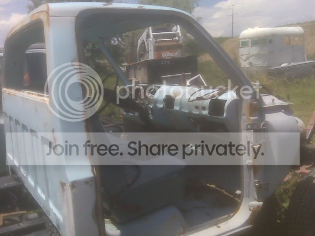

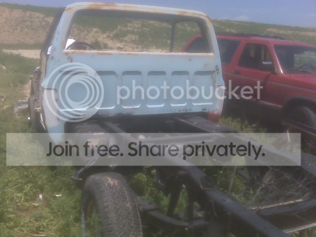

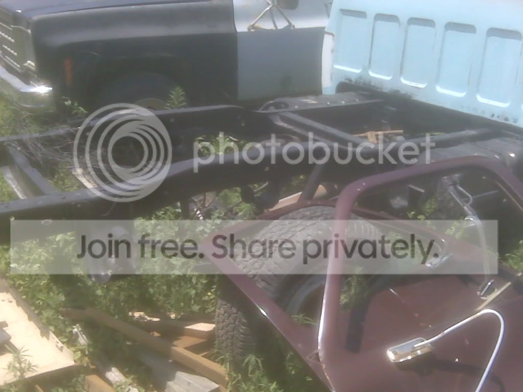

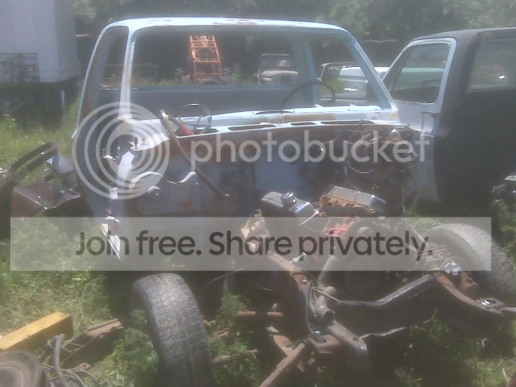

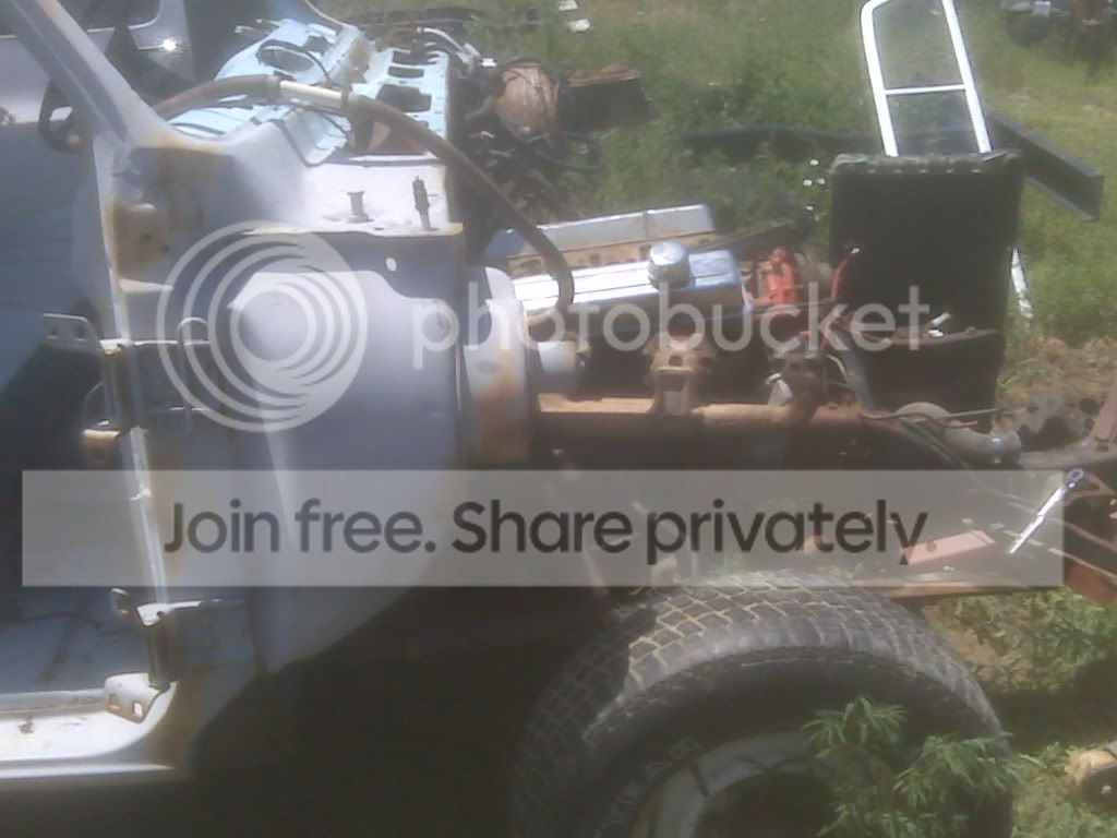

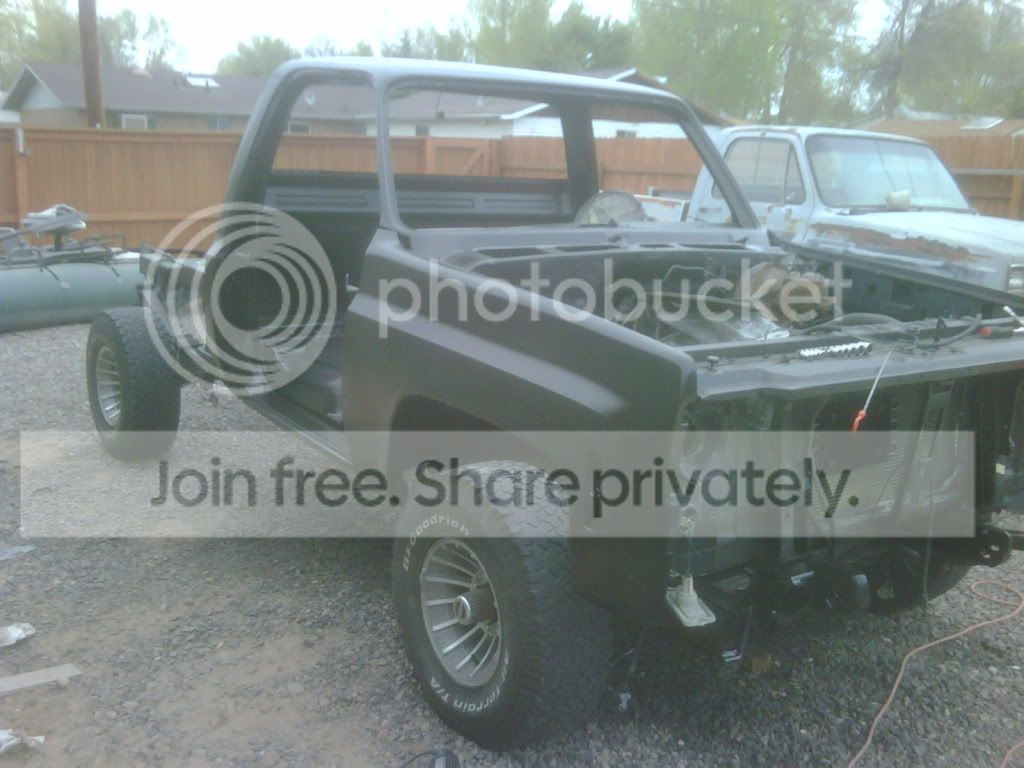

This is how the truck sat when I pulled it from the field. My brother drove the truck for a while, stripped it down, bought new fenders, doors, and hood to do a restoration on it. Then somebody stole the carb off of it and got water in the engine. It sat for the next ten years due to my brother getting busy and discouraged. I picked it up off of him for 800 bucks with a bed and all new panels.

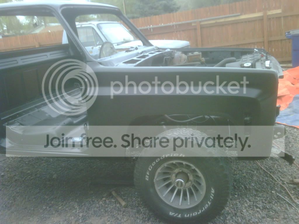

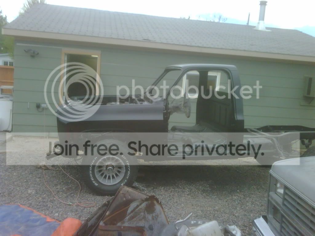

Then I got to work on the body and interior. The cab needed rockers, cab corners and a couple floor patches. I went PPG Satin black Catalyst urethane because of the price tag. If I rub a fender, itll only cost about 15 bucks or so to reshoot it.

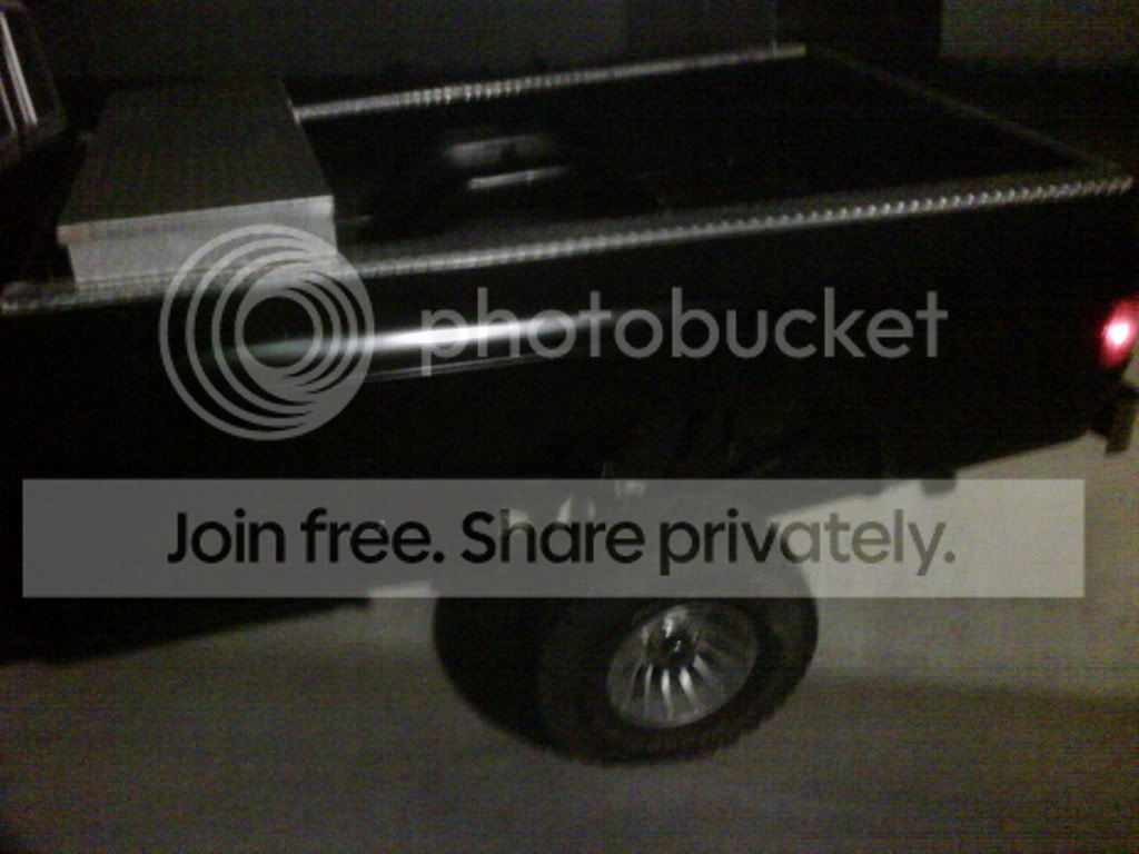

Then I got a box in PERFECT condition for 200 bucks. Got all the body work done and slapped it on the truck. Finished up all the loose ends.
Fancy chrome bumper I scoreed for 20 bucks

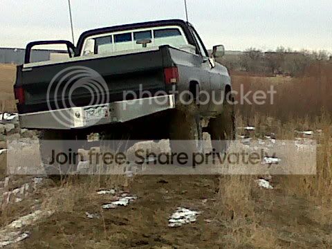

Mall Crawlin' Poser Flex Shot of the Year
Disgusting Chassis flex

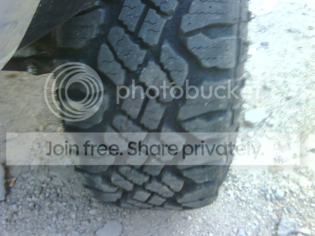

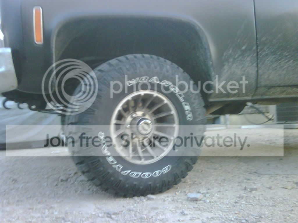

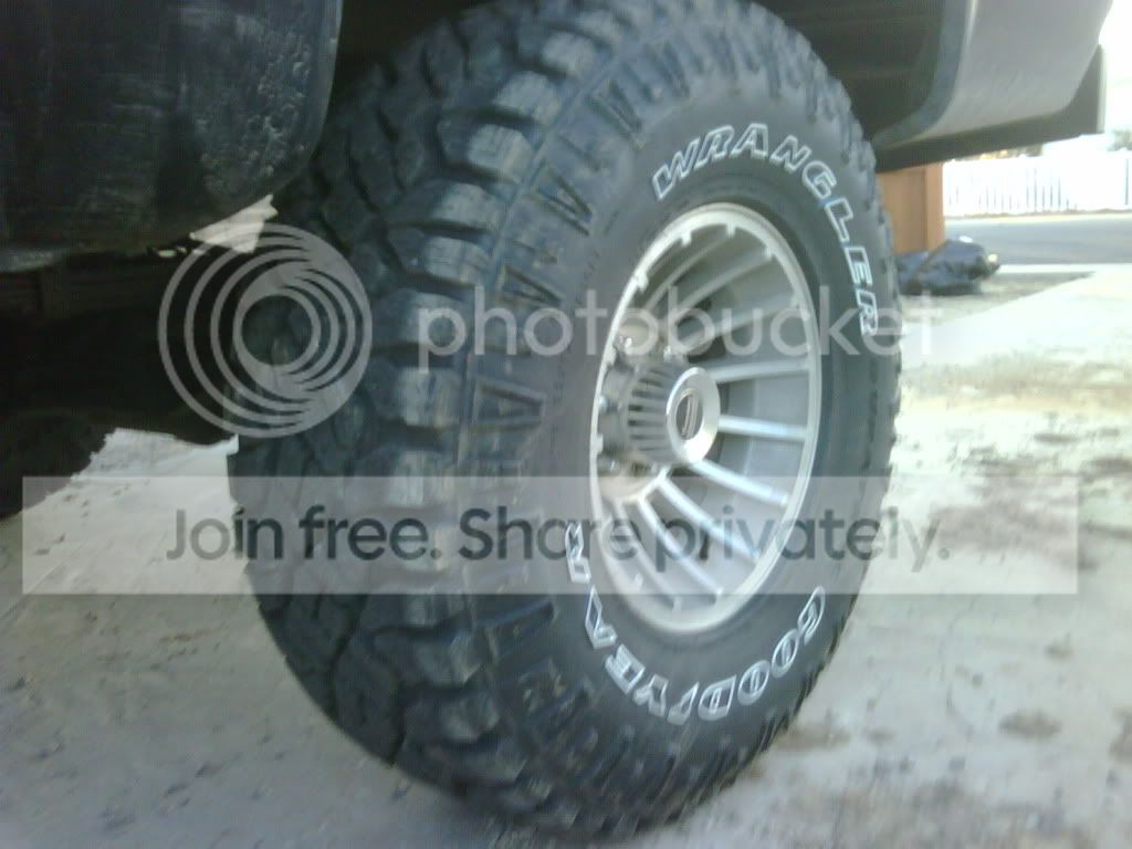

Then I bought some new tires and went off to college. Budget got short due to education expenses (i.e. Thirsty Thursdays)
New Tires

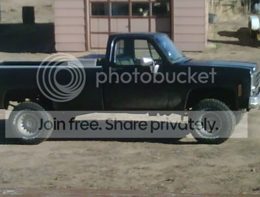

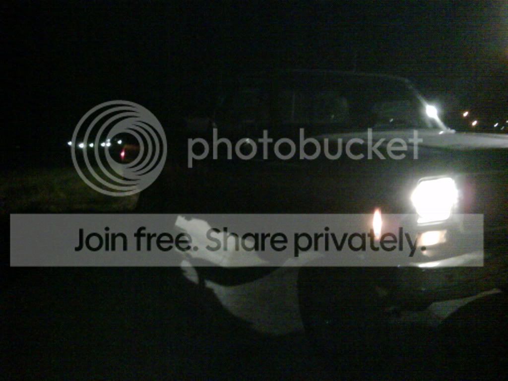

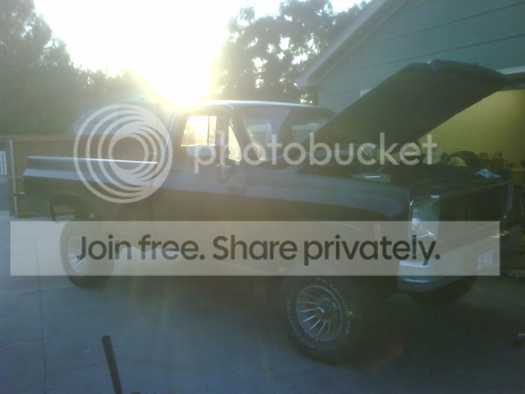

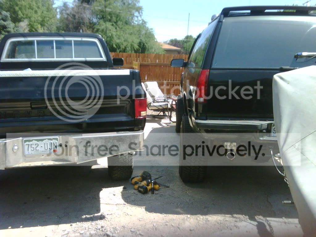

This is how the truck sits now.
I put 3 inch dual exhaust on that dumps in front of the rear wheels on either side. The transmission took a dive so I picked up a solid used one from a friend. Cleaned it up, put a B&M deep pan and shift kit in it. Absolutely love the way it performs now. It acts like an entirely different truck with a happy transmission it. Still have to fix a couple of ground issues and carb issues yet. I cant seem to get the choke adjusted right on the edelbrock and Im having drainback issues with the china-made fuel pump.
The truck has temporarily been put on the back-burner for now due to a suburban project I've started. I might make a build thread, but I'm not sure yet. Not going too crazy with it, just making a decent hunting rig/road trip/tow rig out of it
