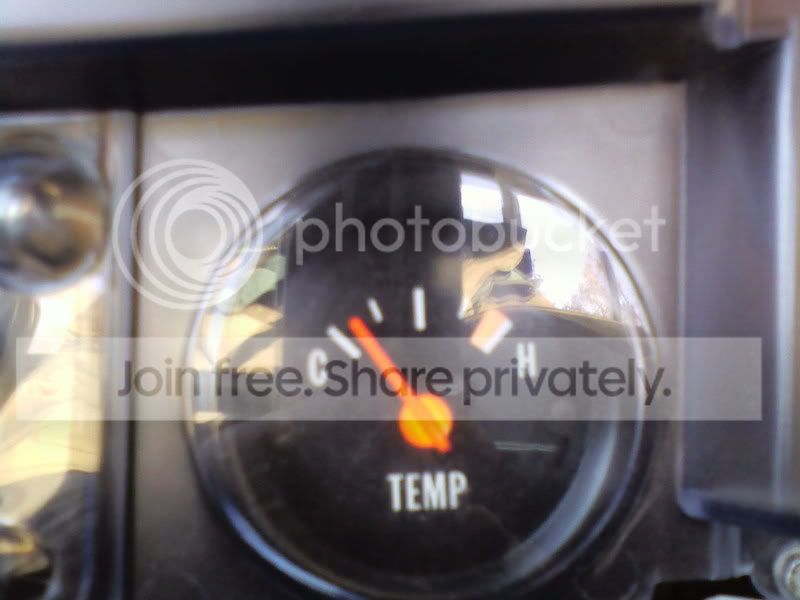

Here's a cellphone pic of my temperature gauge at full warmup. Normally it would just about touch the second white line.
Click for a bigger pic:

Is the engine itself actually that cold? I know what the gauge says, and what it used to say, but have you verified the engine stays that cold?
At that temp I'd expect the upper radiator hose to be cold enough to hold onto, and little to no pressure if you pop the cap. (be darn careful trying this though, of course) Squeezing the upper hose would give you some idea too.
As already mentioned, in a properly working cooling system, the thermostat governs the engine temp, nothing else. That's why I'd want to verify that the gauge is right, first, so you know to focus on either the heater setup, or the engine itself.

I'm sure it's displaying the temperature properly as it only began displaying slightly colder temp when I started having a problem getting heat from the vents.
At any rate, the hose and radiator still gets hot to the touch.
Are you sure one of your heater hoses didn't colapse? I don't trust stock gauges, so I will stay away from that, but I know when my Blazer gets the hoses hot to the touch, there is plenty of heat coming out of the vents. It won't roast you out of the truck, but it will blow warm air.
